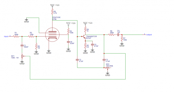

I've just been looking around for some software to draw the circuit diagram but I'm not having much luck - tried ltSpice and 5spice but they don't seem to have the models I need (tubes mainly). I did use livespice for a bit, which does have triodes and works amazingly well, but it doesn't have pentodes so I can't directly draw this circuit with that... does anyone have any suggestions?

I found easyEDA and knocked this up, might be errors but I've tried to make it easy to read - it'd be great if someone has an analysis of it... it definitely oscillates in this configuration, I'll try and schematic the tube version, which I can't get to do that, but that one does sound nice just as a filter...
EDIT: I forgot to add the heater config - I just use 30k high wattage resistors to lower the 12v to 6 ish...

Hey, excellent!!!
