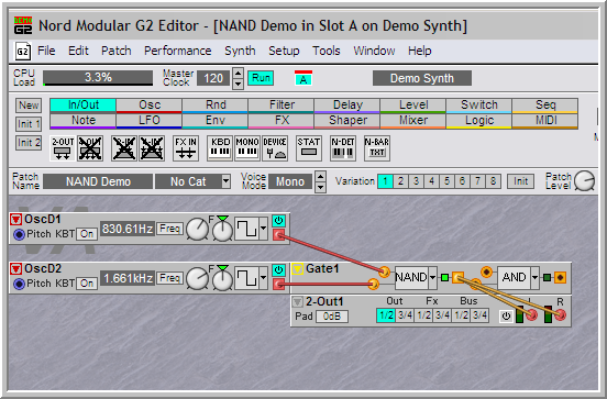

Pehr wrote:
mosc wrote:
For example, you make simple oscillators using digital inverters with RC networks. If you uses NAND gates instead of inverters, you get some sort of neat modulation when you hook up another oscillator to one of the free gate inputs.
Couldn't one use a NOR gate instead and let the extra input act as a mute? Confused That means you could use it as a some kind of VCA, right? turning on and off the OSC? Twisted Evil
There you go. That's what Lunetta originally came up with. Just use NAND gates. A two input inverting gate makes a great modulator. You can built it into the oscillator, or just patch the oscillator into a two input gate. The other input is the "gate" or "mute" signal. Use two oscillators of different frequencies in you get a neat 50 cent modulator.
Here is a G2 patch that shows how a gate can be used as a modulator. I'll probably start a new topic about this because it is so basic. This patch works with the free G2 demo. I strongly recommend everyone interested in Lunettas try out the G2 demo. It has some basic logic circuits you can use to try things out before breadboarding. I'm not pushing that people buy a G2, but this is a great test bed.
 Filesize:  86.43 KB
 Viewed:  60740 Time(s)
NAND Demo.pch2
Demonstates using a NAND gate as a modulator as is done in Lunettas.
Download
 Filename:  NAND Demo.pch2
 Filesize:  910 Bytes
 Downloaded:  2864 Time(s)

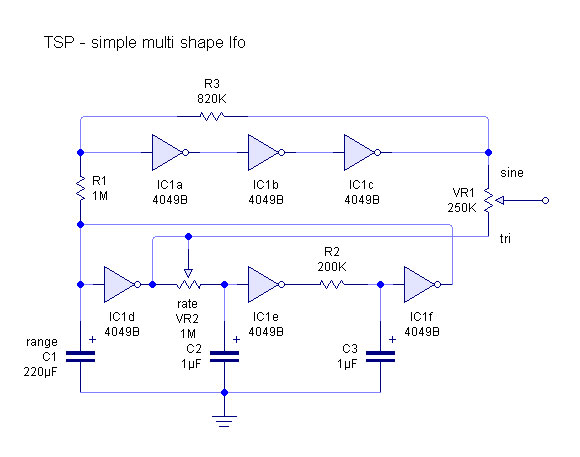

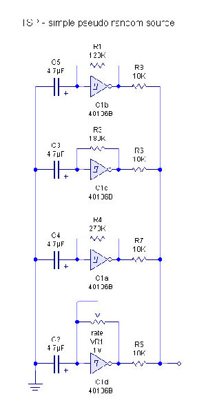

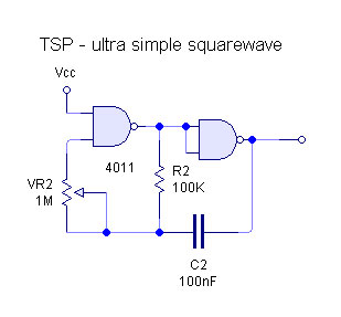

here are a few, common as they are
i know you said square but here is a 4049 tri / sine ( well close enough ) lfo i've used. its not perfect but very usable. using a smaller C1 will get it up into audio range, not sure how well the shape will stay put up there though
a simple as can be 4011 squarewave osc with a fairly good range.
and the all too common 40106 pseudo random square osc
