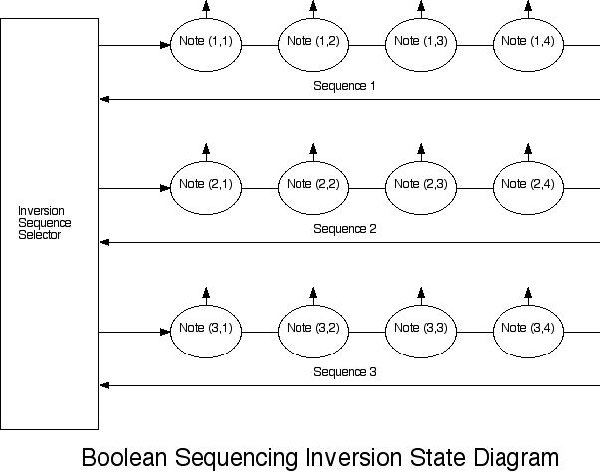

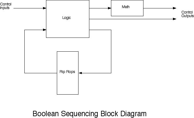

Since the topic is Boolean Sequencing and we're getting precise about definitions and stuff, I thought I would draw up a couple of diagrams to illustrate Boolean Sequencing. Thanks to Acoustic Interloper's recent post we now have a broader concept than I was previously thinking for Boolean Sequencers. This new concept expands the Boolean Sequencer from a binary counter followed by logic and algebra on its outputs to a state machine with algebra on its outputs.
The block diagram below shows the standard illustration of a state machine where logic and flip flops form a loop, plus an algebraic output block. What's new here for Boolean Sequencing is that there are now control inputs that can affect the system, plus the counter has been generalized to be any arbitrary state machine. We still have the math/algebra for calculating note frequency.
The state diagram shows an example of how Inversion might be accomplished by a Boolean Sequencer. In that diagram the rectangle represents logic that selects which state is next, and the circles are states.
I'm just now realizing that I forgot to draw in the random input to the block diagram, but anyway you get the idea.
Block Diagram of a Boolean Sequencer, with new state machine concept.

State diagram of an Inversion-based Boolean Sequencer
