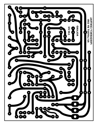

Just made a layout for 4U systems.
I only :
- made smoother traces
- added a MTA-156 pad
- spaced the pots 3/4" center to center.
Apart for that the rest is the same, you can use the parts layout provided by frequency central.
enjoy Very Happy

Is the FrequencyCentral layout from the post 29/12/11 verified? It says "verified ... 30/12/11" on the image but he talks about needing to verify it in the post. Then he mentioned just having verified the layout on the 31st. Confused Question

Hi there Smile
i built 2 X FC EG's, from a PDF.
use the attached file in my post, its verified by me.
enjoy Smile
Roland-100M-ADSR-Build-Rev-2-Doc.pdf
 Filename:  Roland-100M-ADSR-Build-Rev-2-Doc.pdf
 Filesize:  377.76 KB
 Downloaded:  824 Time(s)

I've built three of of this layout, actually changed the layout to allow for 9mm Alpha pots.
Rick sells the PCBs plus panels.

Thanks! I just built my first from the PDF. It's the fastest and simplest envelope I have built. The adjustment is nice even with my linear pots - log must be really great. I want 100 of these Smile
CNC layout: https://github.com/jbeuckm/Roland-140-EG
Working with these substitutions: 2N3904 (flipped), BC556, TL071, TL082
