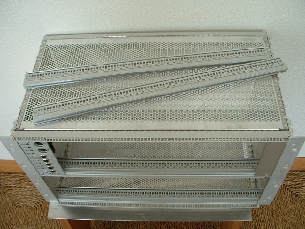

Hi folks, I ordered two of them and they showed up today. I took them apart and made a 6U rack out of the pieces and two new side panels made from aluminum sheet. The racks appear to be Doepfer compatible. The screws to mount the modules need to be 2.5mm instead of 3mm though. You will need torx wrenches to partially disassemble the racks to remove the unnecessary and obstructive PCB slots. I am happy to answer any questions.

Hi Brad, I'll get a pic up today. Not a pain at all, however, AH is all out of Doepfer DIY #1 kits right now, so it's sitting empty. Apparently they will be receiving more in a couple of weeks. I don't anticipate any problems though. Only two recommendations come to mind at the moment. First, buy all you want in one shot so you save on shipping. ie. get 8 of them instead of two at a time. Shipping would be $35. It's $40 for two. Second, combine two 3U together so you end up with two spare rails for mounting the bus boards.

Pics
 Filesize:  67.41 KB
 Viewed:  295 Time(s)
 Filesize:  69.69 KB
 Viewed:  283 Time(s)
 Filesize:  74.71 KB
 Viewed:  303 Time(s)
 Filesize:  71.02 KB
 Viewed:  275 Time(s)
 Filesize:  110.74 KB
 Viewed:  283 Time(s)

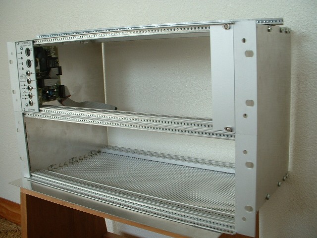

more pics
 Filesize:  84.53 KB
 Viewed:  294 Time(s)
 Filesize:  49.06 KB
 Viewed:  273 Time(s)

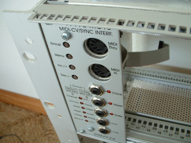

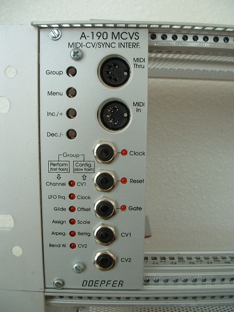

Please note the blank panel that he also has available. He threw this one in to see if I wanted any. If he is selling these cheaply, they might be nice to use for DIY modules!
Note the screw is a 2.5mm dia (normal Doepfer is 3mm), and it's a little longer than the ones used on the Doepfer racks. I haven't yet bothered to get some cheese head versions so the ones in the pic are slotted (standard rather than phillips), so they look a little off, but it all works.
I have not bothered to line up a bunch of Doepfer modules to make sure they all fit across the rack with no HP left over, nor have I bothered to count the screw holes, but you can see that the module lines up on either side nicely.
You can see in one of the pics, the back panel which I have cut to size, but not yet drilled. The aluminum is 6061 0.063" which seems like the appropriate weight for this application. If there is a metal place near you, check their rem pile behind the shear Wink

So they are not that deep, you just had to gut the insides a bit?

They are exactly the same depth as the Doepfer racks. A back is necessary to mount the power supply. I am also going to mount the wall wart transformer inside on the back panel so I can have a regular 110VAC power cord coming out the back of the unit. I did this on another DIY case and it works great. Please note the extra two rails that arise from merging two 3U racks. I will use these to mount the Doepfer bus boards. One thing to consider is the distance from the front plane to the busboards. It should be shallow enough to allow room for the power supply, but deep enough to accomodate your modules. Some DIY PCB boards can be quite deep, so make it as deep as possible IMO. I don't know what an SKB rack is, but this thing is exactly the same dimensions as the Doepfer subrack, so my guess is it will fit into the standard format. Yes, the Doepfer/Cwejman/AS racks are expensive, and they realize that this is killing their module business, hence the Doepfer cheap rack, and the tendency to cram a lot into each module. The problem is the parts add up. Consider these 3U's at $35 (which is a great price), get two, add the aluminum, add the hardware for mounting the power supply and transformer, the power cord, switch, etc, then the Doepfer DIY kit, and you're near $300. In my view this isn't cheap, but at least it's not $550 (or more) which is ridiculous. I think I will just leave the new panels untreated. I suppose anodizing would be most appropriate, but I really want to avoid getting into the $400 range, which is where the used subracks usually sell. By the way, a word on the Doepfer DIY rails, they aren't so great. When all assembled, your modules have enough room to fall down into the case as you are laying them out during installation. This doesn't happen with proper rails as shown here (and on the non-DIY Doepfer racks). This can be a real drag, if you are always rearranging your modules, which you probably are. So in my view these Schroff racks at $35 each are worth it for the rails alone. Doug

The A-190 works great, although I did find that I would have to soft reset it typically to get it to work (press the reset button on the front during power up). Not sure why and it wasn't enough of a pain to look into it further. 12 bits was not a limitation for me.
