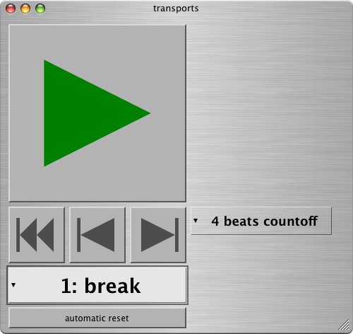

- And of course all of this has to be run by a GUI that a non-technical person could use.

The GUI displays the current section.

GUI for the performer
