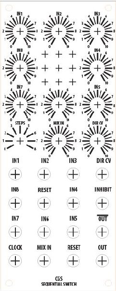

Beautiful! I'll be cramming the same thing on a 2U panel(minus the gate outputs cause those will be covered(mostly) by the master divider)
I'm not quote grokking how the DIR CV works and what the MIX IN and INHIBIT do. Do you think you could explain a bit?
The Direction CV allows you to use voltage to change the direction of the clock.
The Mix In allows you to mix an outside signal in with your output. So if you are running as a sequencer you can add a LFO to the Mix In and it gets added to the sequence... Or when using as an audio switch, throw in some audio signal to mix with all the signals it is switching thru... Mix in is one of my favorite features of this module.
The Inhibit disables the unit when high.
The master divider will give you different options than the Seq Switch gate outs, are you planning a rotary with the gate outs attached to reset so you can set it for different numbers of stages.

The Alison Project wrote:
Oops. Now that I thkink about it, the master divider will only do the job of the gate outputs when the sequential switch is set to 2, 4, or 8 steps and no reset/direction CV is used.
Just did a quick panel layout. The DIR CV pot has a push-pull switch for initial direction. The 9 crosses in the middle are the manual reset button surrounded by LEDs.

Hmm, the more I think about it, the more I want the gate outputs. However, a bigger panel is not an option. I see I have 2 reset inputs on that panel layout Embarassed Perhaps I could turn one of them into a combined gate output and route them there through push-pull switches in the input attenuator pots to retain some of the gate function. How often do you find yourself running more than one of the gate outputs to separate inputs?
Often, but then they are there. Hey, it's an eight stage gate sequencer as well, what's not to love? As for the two reset inputs, there is the option of a reset CV and momentary pushbutton... maybe you were thinking of that? I have a reset button on mine, but I had room for it - I put the whole thing on a whopping 4U MOTM-style panel. Extravagant, I know...
Actually, the cross in the middle of the input attenuators is supposed to be the reset pushbutton. I just made two reset inputs for no apparent reason during a 4am rush-job doh

Neandrewthal, layout looks good... What kinds of push/pull switch pots are you using.

PostPosted: Sat May 24, 2008 9:41 am    Post subject: Reply with quote  Mark this post and the followings unread
Also where from Canada are you from.
Thanks, I use these switch pots.
