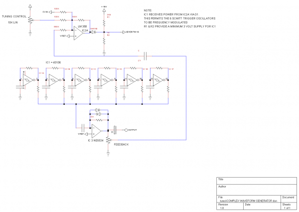

Hey, after checking the schematic on the first page I noticed it doesn't say
which pins on the CD40106 to use.
I just has 2 ? on either side of the symbol.
synthmonger
Joined: Nov 16, 2006
Posts: 578
Location: flada
PostPosted: Sat Dec 26, 2009 4:07 am    Post subject: Reply with quote  Mark this post and the followings unread
There are 6 schmitt triggers you can use. Any input and it's associated output pin can be used; 1-2, 3-4, 5-6, 13-12, 11-10, 9-8 I would not recommend using two next to each other as that will cause some unwanted interference.

However, i've been having trouble making it work. If I connect it to a speaker, there's a pop - it's hanging around some voltage. But I can't hear anything/xoscope shows no oscillation. I did manage to get a square-looking thing from the pulse output once, and I made sure it wasn't my fingers/body causing it, but i've been unable to replicate it. Then again, i've broken many rules:
1. I've chopped off the buffers! I intend to use opamp buffers, after I could see an output. Maybe the current output is so low that I cannot grab a signal?
2. I ran it on a 9v battery! I haven't built my +/-12v power supply yet Embarassed
3. I haven't grounded my unused inputs! Again, I was thinking, hack it together, if it works, make it pretty Wink. However, maybe the 40106 won't output if the other inputs are oscillating? The chip does not get warm at all. It's possible i've blown the chip up tho. I have another 22 (Yes, I did the same as Ryk and got 25) so it's all good.
4. I don't have a scope! Instead i've been using xoscope. I really should put money towards getting a scope.
5. I'm not applying anything to the CV input. This should be fine, tho since I have a pot in place.
6. I used a 2n2222 instead! This could be a big problem, tho the transistor seems to be just a buffer in the linear circuit, and then 2n2222 and 2n3904 are apparently very similar, only the 2n2222 can provide more current (source: wikipedia. I can't visit the page to get a link as the router has just dropped :\).
7. I used a ceramic capacitor...not really a rule but not also a great idea, since they're rather temp. unstable. I couldn't get another kind of capacitor with this value.
I've been thinking it's a better idea to just go and fix these problems- but I came looking for someone to waste the time of here Rolling Eyes Very Happy.
I've checked everything with my multimeter to make sure there are no shorts on the stripboard - it's all good there. And my solder joints are alright too - shiny(ish) and volcano-shaped. Hell, even my chip could be cactus. If it helps, I can make a better version of a layout I made (well, Linux user, so it'll just be something hacked up in Dia.). And if it's something stupid i've done - i'll upload the layout for others to build this schematic. Because from the look of it, this is a great VCO. Sticky?
Oh and since someone else was asked what they had built, i'll answer that question now, for the hell of it:
I've built a MIDIBOX SID. It owns. I have a 6581 module and a 6582 module, which I can swap between but not use at the same time. I don't have many recordings, but if you're interested I do have one I can send, but it's very short (<30s?). I've also built a few modular things here and there...an 8038 VCO, based on the Intersil variable audio oscillator circuit(It has a wave I haven't checked the waveform of coming out of all outputs, and the frequency stability is REALLY bad because of the capacitor I used), a 555 AD/AR, that i've forgotten who designed, a Baby10 step sequencer, unfinished, but should work (prolly not!) and another VCO, that i've forgotten who designed :\. (It was a simple one, I got it off this forum, and it required a single opamp and an LED, that's all i remember at the mo).
To sum it all up, except for the MBSID, a pile of nonworking crap Very Happy.
aaannnd...I'm a bit of an analog purist - but I like PM('FM') synths also. (subtractive) Digital just lacks nature, like what should exist doesn't.
And, even though I may have gone over the char limit: I have awesome plans if I can get this working. I have the keymat from a toy keyboard that I could connect to a row of multiturn pots and make a decent keyboard out of, and everything.
Thanks, doublebeta (looking for a poke in the right direction )
EDIT: Nothing i've built with the 40106 has worked - maybe I did get a bad run of chips?

Hi doublebeta,
Im really new to this, so can't help you with your list of possible problems. But You should be able to get some stuff working with the 40106.
http://electro-music.com/forum/topic-38163-25.html
scroll down and download the quadosc pdf. This is the most basic 40106 oscilator, and if youre getting stuck with the op-amp and r2r ladder I suggest trying just one oscilator with the capacitor and resistor.

doublebeta wrote:
Maybe I should ground ALL of my inputs, even the one i'm using?
Just the unused ones should do fine.

I have placed 100k resistors to ground on my unused inputs and will solder them in tomorrow. I also found that i'm out of wires so I can't make anything more untill I can be assed to go buy more Very Happy.
I found that the battery I used is dead flat. It may have been flat before, but I think it was oscillating and this drained the battery really quickly. However, neither the battery nor the 40106 got hot, so I don't know. Either way, inputs are grounded now, so when I try it, if the chip is dead, i'll swap it out for a new one. I'm hoping that this is just a silly mistake and that I don't just fail at Synth DIY Very Happy.
Failing that, i'm going to install those opamp buffers soon. I might actually highpass (RC around 4hz - is this too much? Too little? Should I just make an active filter out of the buffer?) and add a slight gain on the 'saw' output tho, since there is probably a huge DC offset on that-should be oscillating between the voltages where the 40106 swaps over.

I don't think I will use trigger out a lot for my purposes, so where would I get a normal pulse out from this schematic? Just take the trigger tranny section out and tap in where the base used to be?
Also just so I understand correctly, if I don't want to use the V/Oct section, all power rails are 9v??
doublebeta
Joined: Feb 26, 2010
Posts: 5
Location: Australia
PostPosted: Thu Apr 21, 2011 5:31 am    Post subject: Reply with quote  Mark this post and the followings unread
No, not a good idea. The transistor is used to buffer the output (reduce load, so that the oscillation isn't affected/doesn't stop). Do not remove it. Maybe change the resistors to get a 'normal pulse out'. Note that you will always get the same duty cycle, unless you modify other parts of the circuit.
Yep. Just pretend that the exponential bit does not exist at all. I got mine working from a 9v battery.
...regarding my other posts, I got it working on breadboard, don't know where I put the vero'd version. Used opamps for buffers instead of transistors.
edit: I like your username Smile.
Ok, I think I understand. I had looked at the version in THIS thread so I figured it would work the same in other contexts.
Does anyone know if it is mostly the ratio of R3 and R4 to affect duty or does the magnitude have lots to do with it as well?

6581r4AR wrote:
They don't affect the duty cycle at all. It will always be an ultra short pulse.

Ok. That makes sense. On the example in the link I provided it DID say 1ms pulse out. I guess I didn't think it was the same thing as trigger out.
So I will just get square out of a vanilla 40106 osc with a transistor over the feedback resistors. Does the transistor have to have the emitter pointing towards ground cap on the inverter input?
May have misunderstood the question, but you will NOT get square out from _this_ circuit at all.
If you want a square out, run it through a divide-by-two circuit, which is basically a D-type flipflop with the inverted output connected to the Data line and the 1ms pulse connected to the clock input (I think...)

PostPosted: Tue Jul 17, 2012 1:11 pm    Post subject: 40106
Subject description: VCO
Another way of making a VCO with the 40106 is to vary the supply voltage. The relationship is far from linear and is also inversely proportional, that is the output frequency falls as the supply voltage is increased.
The other issue is that of the output amplitude varying with control voltage, if you are using the squarewave output it is easy to convert to a fixed output using 1 npn transistor as a switch, if you wish to utilise the saw / tri waveform on the capacitor this can be corrected with a subsequent vca. I used the six schmitt triggers toghether feeding a diode clipper to produce a complex atonal sound.
see below:
I wouldn't say that's a VCO, it's a method of power starving. However your circuit is very interesting, that feedback control looks like it would have a very interesting effect, you should have made a thread for it! I'd like to hear it in operation Smile
The inverse relationship between frequency and input voltage is due to the hysteresis voltage of the 40106, the schmitt trigger trip points will vary for different supply voltages, getting further apart as the voltage increases.
