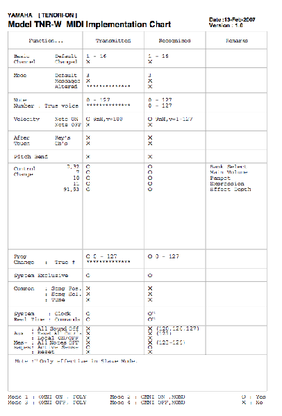

i dont think it sends cc-values though.
but everyone who ows a tenorion is begging yamaha to implement this into the next update.
this is the chart btw;
midi impl. chart tenori-on
 Filesize:  79.16 KB
 Viewed:  225 Time(s)

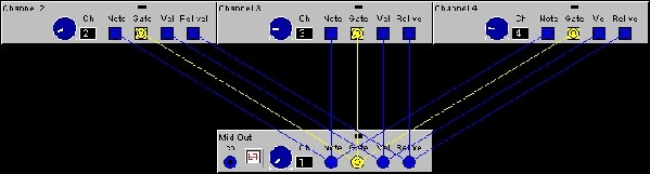

The Micro has only one Slot, so it can be set to any Midi channel you like.
If you want it to react to more then one Midi chammel you'll have to merge to that particular Micro Midi channel.
Jan, - eh... Blue Hell Wink - is it possible to use MidiMod merging Midi? See attached picture...
Wout
MidiMerger using MidiMod
 Filesize:  79.65 KB
 Viewed:  234 Time(s)
Wout Blommers
Joined: Sep 07, 2003
Posts: 4529
Audio files: 123
G2 patch files: 12
PostPosted: Wed Oct 01, 2008 3:25 am    Post subject: Reply with quote  Mark this post and the followings unread
I've tried using MidiMod and it works in a way, only the MidiNotes are added to each other, so Note 60 played together with another Note 60 will result in one Note 120 Smile
Strangely enough using only the NL2's Arpeggiators MidiNotes stay the same, only mute when played almost at the same time. In this situation all NL Slots send on the same channel.
Another finding is when in MidiMod (or G2 Midi set-up) only one MidiNote value is used together with more Gates, only the MidiNote/Gate (e.g. channel 1) will sound, where the other Gates remain silent...

You could try to use multiple output modules all set to the same channel I guess? When you mix signals like you did they will indeed add up.
