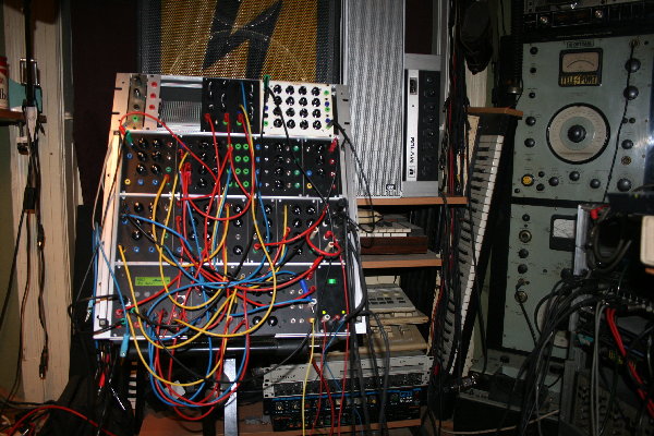

PostPosted: Sun Feb 20, 2011 3:23 pm    Post subject: Reply with quote  Mark this post and the followings unread
Smile
