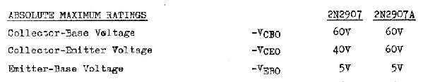

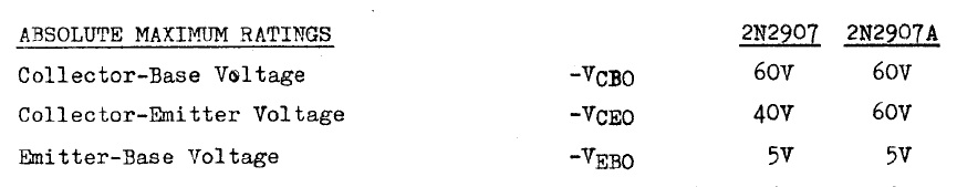

what does this section from the 2n2907 datasheet mean?
does the emitter > base voltage suggest that the emitter maximum rating is 5v?
All three values say something about voltages at which the transistor might be destroyed (when current is not kept under control).
* -VEBO is the reverse Base Emitter voltage with Open (not connected) Collector.
Reversed in this case means (as it is a PNP transistor) that the Emitter voltage is lower than the Base voltage. This is not the normal working mode of the transistor, but rather the voltage at which the BE junction starts to go into Zener mode, i.e. it starts to conduct in a direction that is not the normal conductance direction. 5 V is not an unusual value for VEBO for transistors, most designs will stay out of that region.
* -VCEO is the Collector Emitter (Open Base) break down voltage. the voltage at which (destructive) current will start to flow although it is not supposed to (because no Base current flows out).
* -VCBO is the Collector Base voltage with open Emitter at which the device will break down on that junction.
All values are not unusual for lowish power transistors, and they are not prohibitive for "normal" low voltage circuits. The voltages you measured on the device are well within specs and do not indicate the transistor to be malfunctioning as far as I can tell. I can't tell from your numbers but it could still be that you exchanged the Emitter and the Collector (that would make it into a not so good working transistor), but you'll have to look that up in the data sheets ... the one I saw (here, the Siemens one) BTW mentioned that the metal can is connected to the Collector, so be sure that the can is not touching anything.
