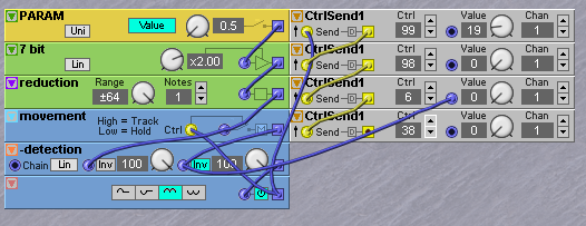

PostPosted: Sun Apr 02, 2017 1:30 am    Post subject: Reply with quote  Mark this post and the followings unread
Hello, thanks I didn't find this post!
I've tried it, it seems to be seemingly correct, but I haven't figured the range yet.
I'm trying this with Andromeda filter, and it requires values from 0 to 31 for CC6 (coarse) and 0 to 127 for CC38 (fine, I've added a module for that one), nor I've had success to hear proper sweep (even coarse) so far.
It seems at times the CC won't be sent in good order or consistently also.
I'll need more experimentation but this seems so close... Maybe I just need to do it with a small program on my computer instead but this is a bit cumbersome if the G2 can do it.

You can control the order things are sent in by chaining the send in and outputs.

PostPosted: Sun Apr 02, 2017 5:57 am    Post subject: Reply with quote  Mark this post and the followings unread
Mmh I'm getting weird midi things through ableton live, somehow it doesn't route those controller changes despite activity shown correctly and midi notes going through, looking further, ableton is so retarded that it does only let the CC6 through but blocks 99, 98 & 38 altogether.
When I patch my G2 midi out directly without the PC, via midi patcher it does send correct changes
[00019918] a6 channel ControllerChange (channel:0) 99 19
[00019926] a6 channel ControllerChange (channel:0) 98 0
[00019926] a6 channel ControllerChange (channel:0) 6 0
[00019926] a6 channel ControllerChange (channel:0) 38 31
[01233832] g2x channel ControllerChange (channel:0) 99 19
[01233832] g2x channel ControllerChange (channel:0) 98 0
[01233832] g2x channel ControllerChange (channel:0) 6 2
[01233832] g2x channel ControllerChange (channel:0) 38 0
I'm still noticing those problems:
* sometimes the value sent get mixed up, it can be sending only the 99CC or the 6CC, or some random pairs
* I'm not able to figure out the range thing, it seems the A6 wants 12bit resolution
 Filesize:  61.56 KB

PostPosted: Sun Apr 02, 2017 6:22 am    Post subject: Reply with quote  Mark this post and the followings unread
From Tim Kleinert :
The problem in the NRPN scenario is that the first two CC messages of the NRPN protocol do not change. So, one has to detect a change in the value to be sent and use this to trigger the sending of the entire NRPN string.
http://www.electro-music.com/forum/post-393441.html#393441
Did you tried the patch from Sinuosity or Tim Kleinert ?

PostPosted: Sun Apr 02, 2017 6:25 am    Post subject: Reply with quote  Mark this post and the followings unread
Electromagnetic Wave, yes I've changed Tim's patch as shown in the picture.
It does send the 4 CC, albeit sometimes not properly as it kind of trips up (noticed especially when decreasing the value) and I'm not able to figure out how to do scalling to have something smooth happening.
Posts: 24599
Audio files: 309
PostPosted: Sun Apr 02, 2017 7:23 am    Post subject: Reply with quote  Mark this post and the followings unread
Random transmit orders could be caused by (from the module help) :
• Note that as soon as the Value changes, either by manually turning the knob or by inputting a changing control signal, the module will output MIDI data even if the logic Send input is not activated.
So you'll need to sync changes there ... hairy stuff Confused
