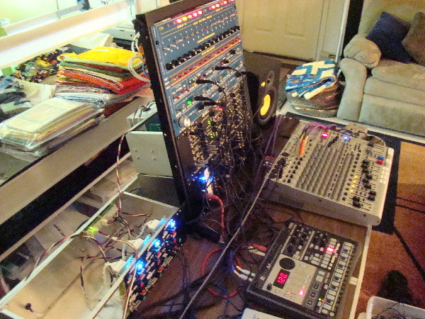

Posts: 2810
PostPosted: Sun Mar 15, 2009 2:02 pm    Post subject: Reply with quote  Mark this post and the followings unread
use the trigger outs from my tr-505
Nice Gabba Cool Triggers for free !!! Wink
At times when I have no computer in my setup, I use my Korg EM-1 as a master clock source, then go to MIDI2CV and clock my modular and Klee sequencer from that. I usually dedicate one drum track to send out notes either on a regular beat (1/4, 1/8, 1/16, etc ..) OR send out any pattern of notes I wish. Another track is assigned strictly for sequencer RESET or LOAD pulses so that I may truncate sequences on the fly. I can place a LOAD for the sequencer anywhere I like within the 4 measures allowed on the EM-1. Now I can stutter the Klee if I want. The sequences then get intense and it adds good change ups so things don't get boring. !!
Bill
