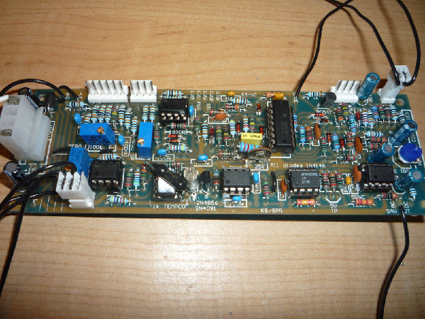

So I'm using a J108, I checked the orientation and it seems correct.
Also, no missing jumpers or anything...Checked that like 50 times Smile
Here's a pic for reference.
Thanks again!

From looking at that picture it appears you have no zero volts going to the circuit?? This could be a problem
Probably the most common problem i have when testing a new circuit is that the power rails are not correctly reaching the circuit....Just a thought
Luke
Luke
I agree there. Looking at the power input 0.156" connector, there're only +15 and -15 wires coming into the unit. Is the main Ground for the PCB hooked up to your main power supply?
Another observation: there're temperature related resistors, all over the place in this PCB. ??? (The 6 banded ones. Last colour ring on these - it's colour stands for the % of difference the resistor has, as per the surrounding temperature, if I recall correctly.
I wonder - if this resistor type (instead of 1% resistors) could have any factor in this as well? (Anyone - please correct me if I'm wrong.)
