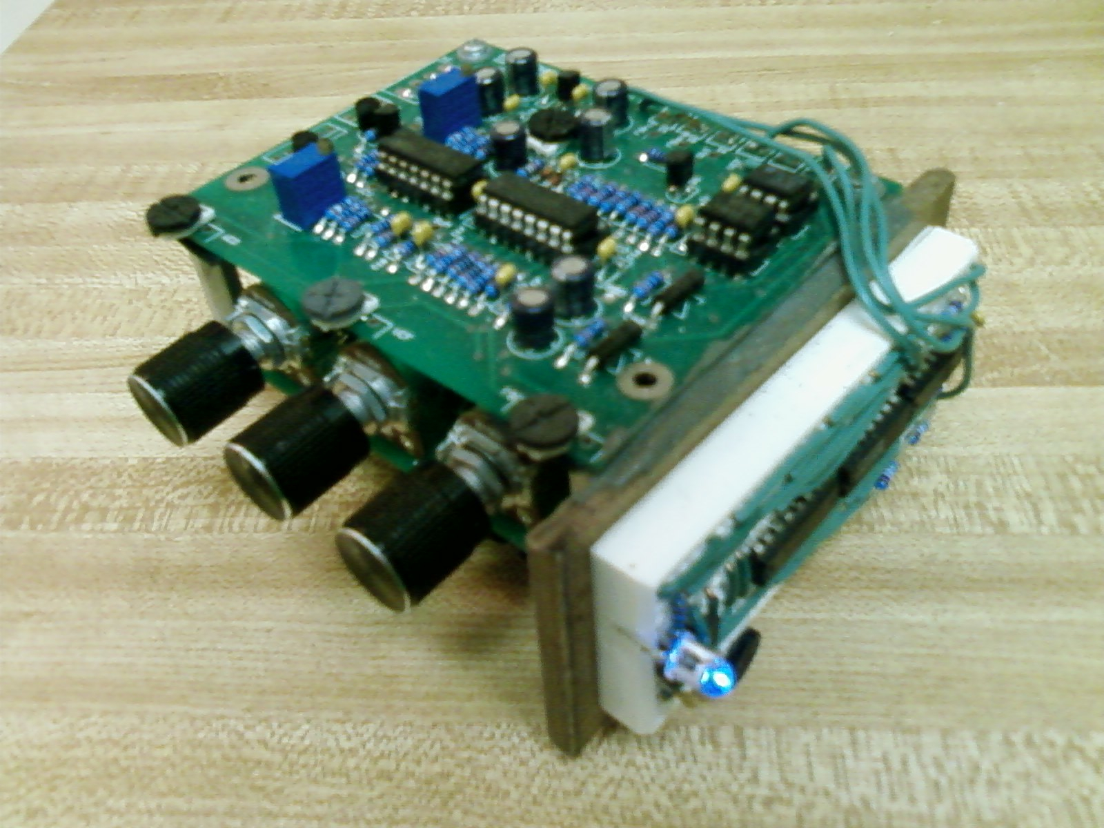

PostPosted: Sat Aug 21, 2010 4:48 pm    Post subject: My Karplus Strong Modules is up and running! Reply with quote  Mark this post and the followings unread
Well, it turns out that I did not fry my BBD chip. The culprit was that I fried one of the zener diodes (the one that connects to ground). It was pulling the feedback signal so low that the only thing that made it through was the stim signal.
Additionally, I had to replace Q2 (the PNP transistor for the VCO's expo converter). I am now getting a good voltage swing from Q2 as a result.
The module sounds great! I have to mess with some resistor values to sweep the VCO through a larger range. I will share the results when I determine good values.
Well, one advantage to my little "trial by fire" is that I think I know every part in the circuit!

Well, after a brief hiatus away from electro-music, I'm ba-ack! I don't recall if I had posted a photo of my "The Brick" music synthesizer, shown below, which makes BS/KS/KS sounds so here it is.
A breadboarded Boolean Sequencer drives a shorter BBD Karplus Strong board to create the basic sound source, then another long BBD Karplus Strong board acts as a resonator. With this setup I can produce a wide range of sounds in three main regions: Normal, Deep Bass, and Overdrive. Also many adjustments within each region and transitions between regions are possible.
To finance continued developments in the Karplus Strong project, I am offering The Brick for sale. I may not get any takers though because I feel that I must set the price at a fairly hefty $300. It's got about $150 worth of parts in it so that's a 100% markup to cover all the labor in creating a custom design. Also The Brick has somewhat of an electro-music historical significance in that it contains a Boolean Sequencer developed by myself on em, a KS rev 2 board as the audio sound generator, and a KS rev 1 board as the resonator. The Brick also includes an obsolete MN3209 BBD chip to make it extra-unique.
The Brick will get shipped to the first person to send me a private message on electro-music's PM service, followed by PayPal payment to lester.hall@comcast.net.
