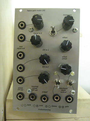

okey-dokey, I swapped out R1, 2, 3, 4 with those values for +/-7.5V for 12V module...this gave me -7.5V and +7.12V.
Result is a lot better, there is still a tiny bit of clipping, but with a 100K resistor in place of R18 on the LPG this is manageable by attenuating the input signals more and use of the offset and offset trim on the LPG (I would probably recommend putting the offset trim on the panel for extra tweakability). An interesting thing I noticed as an aside is that clippping was more likely to occur when the VCO was being FM'ed for some reason...
Fonik, your electronic mode control board works wonders, thanks for all your help!
PS it will clip in both mode if R18 less than 100K

The 'offset' knob is the offset pot, 'offset offset' is the offset trimmer mounted on the front panel, this is it for this version, I'm only going to make 2 of these for 12V operation...
As I am now pretty happy with the metal panels and lazertran I could take this opportunity to add some kind of 'distortion' switch to the 15V version as I re-panel them...
One thing I do wonder, does it matter that the expansion board is giving slightly unequal power to the 4053 (-7.5V and +7.12V)? I may have another look at this, could be a poor solder joint or or something, I did bodge it together a bit!

it should not! i am using 1% resistors, which is suffiecient. if the power is not balanced it would 'bias' the 4053.
