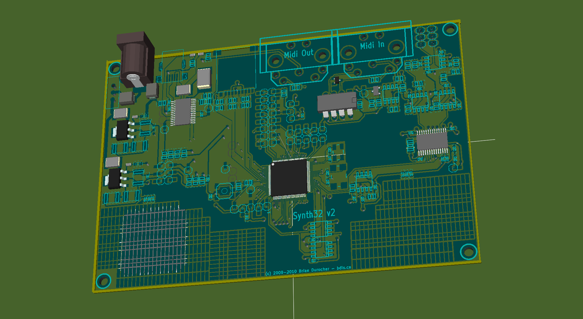

Errors.
There were some serious errors on the first run of boards, due to incorrect pad sizes and spacing. The TQFP-100 I used and the TQFP-100 Microchip uses are completely different. So I have taken the month to redesign the board.
The board now has +5/-5 and +3.3v power, I am designing an amplifier section which will be suitable for high-pass or low-pass in the 5th order. And the DAC will be connected correctly this time. The I2C connector was connected to general i/o and not the I2C interface on the PIC. That error I should have caught the first time.
The second version has much larger pads for accessing every additional pin on the pic. With spacing which would allow for a pin header to be soldered to the extra pins.
The prototype area is much larger including two additional areas on the front and back side of the board. And the pads in each area are larger which will make it wasy to hand solder parts onto them.
There have been general optimizations across the entire board, better layout, gound planes for 5v and 3v to separate them. I am still trying to decide if I should plan to use decoupling capacitors on the board but I think the design won't require this.
So thats what I have done so far. The next run of boards should be on within the next few weeks. I have ordered more DAC's from Mouser, as DigiKey is out, and the remaining parts have arived from there suppliers. So things are still moving along although a litter slower, as I am taking more care in designing the second run.

Well good question and the only answer would be that I have been able to get decent results with out them.
I have plenty of bypass caps on the board to smooth power out, but as for decoupling I have never really needed them.
In the past I have used decoupling only for audio inputs and a few supplies I did not want directly connected. Whats your advice Inventor, I know you have spent a great deal of time in the field and your recommendation is appreciated.

Oh, it's a terminology thing. I've always heard the power supply caps called decoupling caps. I thought you were not using supply bypass caps when you said you didn't need decoupling caps. My mistake I suppose. Sounds like you have the situation well in hand. Good luck!
Nice!
Better safe than sorry. Adding extra hardware might introduce oscillations into the power lines. If you have some place where the +V and ground are adjacent all it takes is two extra solderpads.

PostPosted: Mon Apr 05, 2010 10:20 pm    Post subject: Reply with quote  Mark this post and the followings unread
So a little update. The new boards are finally redesigned. I am looking forward to placing another prototype order this week. I have decided to rework the prototype area again and adjust the pad size making them larger and easier to work with by hand; in addition the area was expanded.
