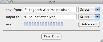

Hi, I've got Jack and Nicecast installed on a new Mac mini. I'm trying to get the wireless usb headphones, iTunes, ChucK, and Ventrilo to all talk on Nicecast. I am making zero progress. I can select any one sound source but only that sound source goes into Nicecast. The voiceover in effects of Nicecast doesn't work either. What am I doing wrong?

Paul provided me some links to articles that explained how to use Soundflower. I followed the instructions for setting up a mic into soundflower and then set soundflower as the audio device in Nicecast. Nothing. No audio. I cannot do my radio shows unless I can do this audio routing, this sucks. Can anyone help?

the Line In screen

Oh wow, just after posting that I got it working! I had to click on the pass-thru button in Line In. Hopefully I can also get Ventrilo working for live interviews.
