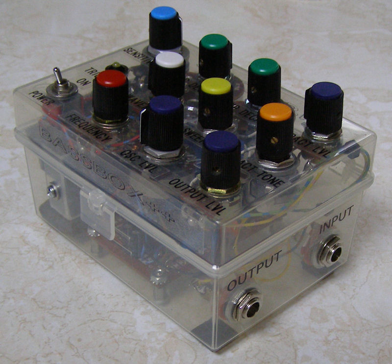

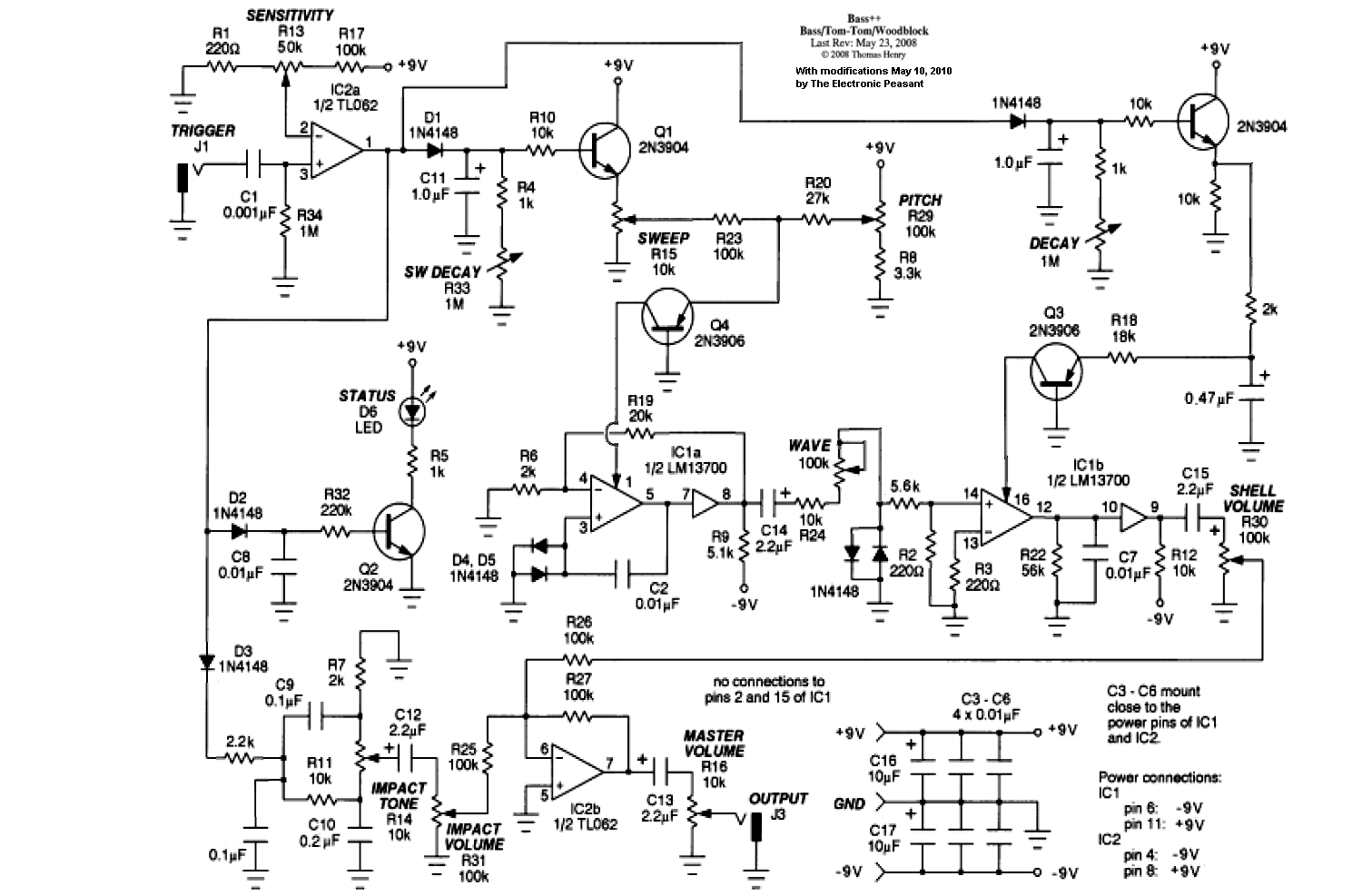

Bass++ mods? Yeah, I have a few.
I have actually spent the last weekend modifying this circuit, as I am building a small drum module to be triggered by a bass drum pedal striking a piezo sensor. This is so I can keep a basic beat with my foot while playing other instruments with my hands and singing.
Firstly, I left out the pitch CV input as I wasn't planning on using it in this project. So J2, R28, and R21 were simply left out.
Next, I changed the supply voltages to +/-9 volts, so that the whole thing could be run off of two 9 volt batteries. To compensate for the lower voltage I changed R5 from 1.5K to 1K to keep the LED brightness approximately the same. To reduce power consumption, I replaced the TL072 with a low current TL062 chip as well as raising the values of R1, R13, and R17 to 220R, 50K, and 100K respectively.
As this module will be used almost exclusively for bass drum sounds, I doubled the value of C2 to 0.01uF to lower the oscillator frequency range.
I wanted separate envelope generators for the pitch and volume functions, so I duplicated Q1 and associated circuitry. (Includes D1, C11, R4, 10, and 33) I also increased the decay potentiometer values to the more standard 1M, allowing me to decrease C11 to 1uF. This was done on both envelope generator circuits.
I found that triggering this circuit with a piezo disk caused some annoying popping sounds to be generated from the "impact" circuit, so I added a 2.2K resistor and a 0.1uF capacitor between D3 and R11/C9 to filter out some of the transients and lower the overall impact tone. Similarly, the "shell" VCA output also had some bad popping sounds, especially during short decays, so I added a RC filter to the current source. This entailed changing the value of R18 to 18K, adding a 2K resistor between it and the 2N3904, and adding a 0.47uF capacitor from where the two resistors connect together to ground.
Finally, I wanted some type of waveform control such as what the ADV Bass and UD Bass had. So I added a diode-based variable clipping circuit between the oscillator and the VCA sections. To do this R24 was changed to 10K, followed by a 100K potentiomenter, which then connected to two opposite-polarity diodes connected to ground, and finally a 5.6K resistor connecting to IC1 pin 14.
I am extremely pleased with how the circuit is performing now, and am especially happy with the waveform control. The sound can now be adjusted from the original "buzzy" triangle wave to a very smooth sine-like wave and then to a very resonant sounding almost-square wave. A very versatile drum voice is now even better!
I have included an updated schematic below, as well as a sound file showing the changes in sound produced by adjusting the new waveform control.
Take care,
Doug

I really love this project and case you made. I went over to your website to check the project out and wondered if you can provide some details on you Piezo trigger?
Hey, I am thinking for an added wow factor, and since the case is clear, it would be cool to put some super bright LED's inside the case so that when it triggers, the entire case pulses with a beautiful glow of light nice for on stage stuff.
Bill |

| State Machine wrote: | | I really love this project and case you made. I went over to your website to check the project out and wondered if you can provide some details on you Piezo trigger? |
Thank you very much for your nice comments! The details for the trigger/pedal are on this page: http://www.electronicpeasant.com/projects/ssdrums/ssdrums.html
| Quote: | Hey, I am thinking for an added wow factor, and since the case is clear, it would be cool to put some super bright LED's inside the case so that when it triggers, the entire case pulses with a beautiful glow of light nice for on stage stuff.
Bill |
That is an excellent idea! My only concern would be battery drain, but if they only flash when triggered it shouldn't be too bad.
Take care,
Doug _________________ The Electronic Peasant
www.electronicpeasant.com |

Actually, I didn't notice this when I tested my proposed Impact to CV mod the first time, but it turns out the actual pitch bump is down rather than up. It's a subtle difference but as I played around with it, with no additional sweep to confuse me, I got some more pronounced effects and it became clear that it was inverted from where I want it. Still a useful effect, especially if you are synthesizing a bass tabla.
I've been reluctant to add much more circuitry to my build, but I'm considering a simple inverting op amp to fix this, running the output into the R20, R21, R23 juncture. Of course, those of you who have built Doug's independent decay control mod won't need this, but I couldn't spare the pot space so a switch is the best I can get. I could even do on-off-on with the ons being + and - respectively. |

Hi, I'm trying to make this "pitch bump" mod work out, and using an inverting op amp I'm able to get a pretty desirable result, much cooler than the sample I posted earlier. My only problem is how to get rid of some DC voltage (about .5v) which causes the pitch of my bass++ to go lower.
The concept is simple:
CW of Impact Volume pot is connected to (-) input of a 1458 opamp via a 27k or 54k (switchable for more or less pronounced effect). (-) input is also connected to output via 100k resistor. (+) output goes to ground. Meanwhile the output connects to the CV junction at R20, R21, and R23 via a 47k resistor.
So the issue is the pitch drops to sub-audio for 10%-15% more of the pot's rotation. If I merely raise R8 will it solve my problem? Or do I want some other means to remove the DC offset?
Admittedly, I don't really get all the theory behind this. I'm inverting the Impact's voltage spike and amplifying it by 2x to 4x and using it as CV. Some of the choices (like the 47k to CV) are just trial and error. I don't fully understand where positive DC voltage is introduced. (Wasn't it blocked by C12?)
Any advice is appreciated. Apart from getting this offset issue cleared up, this is turning out to be a very nice addition to the drum sound. I'll post updated clips and a schematic when I get it worked out. |
