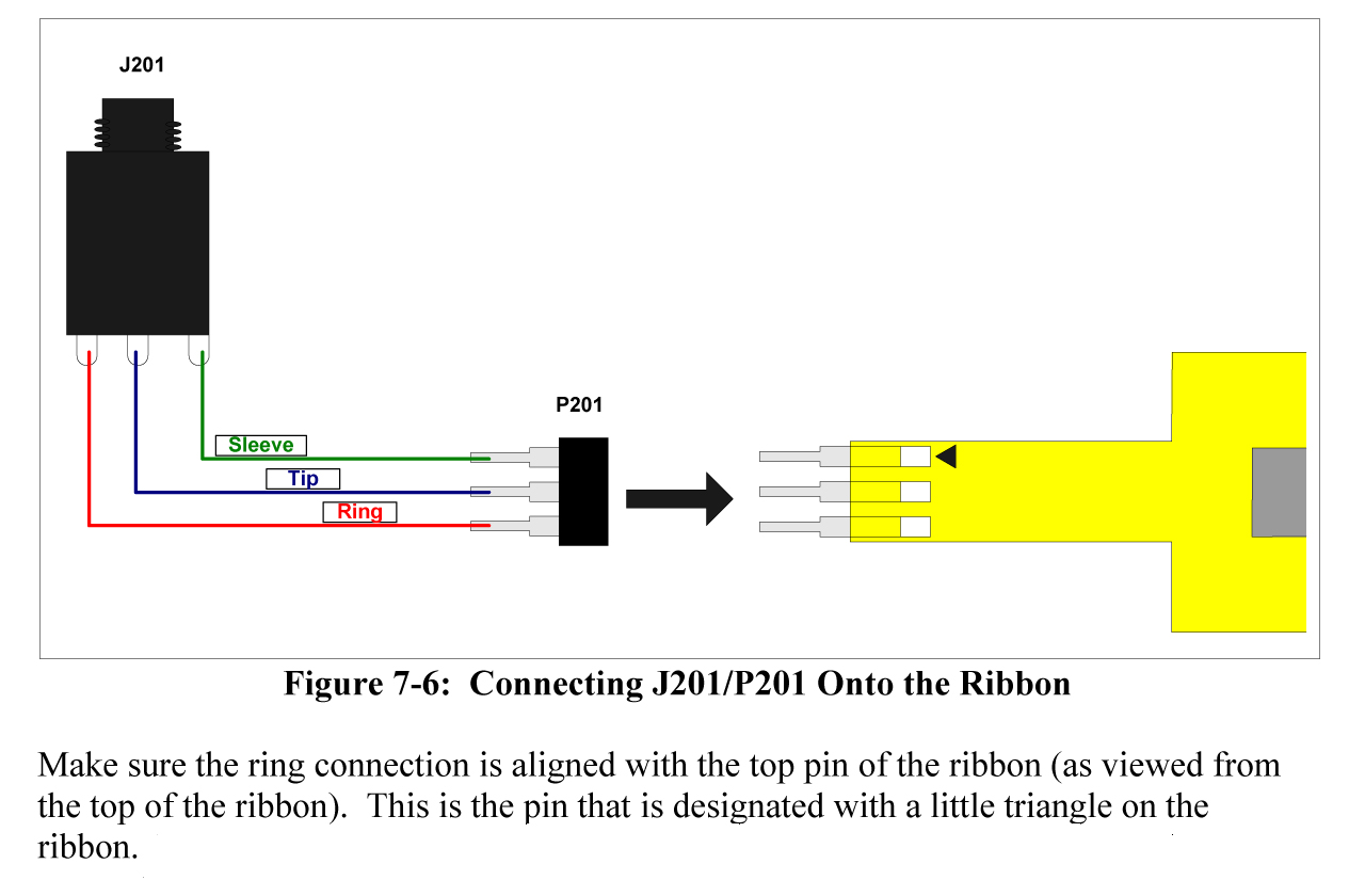

I found a possible error in the build manual. Figure 7-6.
The illustration contradicts the text.

Scott Stites
Joined: Dec 23, 2005
Posts: 4127
Location: Mount Hope, KS USA
Audio files: 96
PostPosted: Thu Feb 24, 2011 5:33 pm    Post subject: Reply with quote  Mark this post and the followings unread
Yipes!
I believe the illustration is correct. The text is not....
Thanks, Photon!
