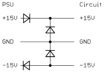

i recently read a little bit about reverse polarity protection. i found two described electronic solutions, serial diode or parallel diode. a third method using a relay is rather expensive.
serial:
parallel:
however, when i tried the serial diode (i used a schottky BAT85) i still saw about 1.7V when applying reversed voltage. the actual circuit was just two LEDs with resistors.
so i ended up using both, serial and parallel. looks like this:
any thoughts about this?

Hello Fonik,
The most usual I have seen is only two 1N4002 in parallel. (+ to ground and - to ground)
In series will drop a little the voltage of the supply.
I don't know if the remaining less than 1 volt could damage something.
And it is expected that the fuse of the power supply blow up.
In Eurorack with module connector only with 10 pins, if reversed the connector in the bus board ,CV ,+5 and +12 will be sent to the ground module and then will sent to the ground bus board through de diode. While, signal GATE if present will be sent to the negative rail of the module and then will sent to the bus board ground through the two diodes.
Maybe seems interesting to these two diodes (+ to ground) and (- to ground) add a third diode ( - to +).
Doing it I noticed also that the remaining voltage when shorted drop to less than half of volt.
Also in Eurorack, if the module connector has 16 pins, in addition to what I said you should consider that the negative rail of the bus board will be sent to the module GATE if it does exist.

hey Fonik,
the parallel solution looks reasonable to me for 10 pin hdrs. i did not add this to my modules, just marked the PCB clearly. if you were to add small resistors in series with the power lines, you wouldn't have to rely on your power supply's fuse and/or over-current shutdown mode, as the small resistor would burn up like a fuse pretty quickly and the rest of your modules would go on about their business while yours is taken out of circuit.
Blacet uses the same concept with PTC resettable fuses I believe.
http://www.mouser.com/Circuit-Protection/PTC-Resettable-Fuses/_/N-5g3e/ more expensive, but no repairs would be needed [assuming the leakage current is small enough when it's activated that it does not hurt the circuitry]
the idea is that when an over-current situation occurs, like when the diodes conduct and short B+ or B- to gnd in a reverse power situation, the resistance of the PTC goes way up essentially cutting power to the module.
they are generally very fast acting.
If my PCB markings aren't enough to prevent this situation, I will definitely be adding this myself in the future Smile so far, so good as far I know.

Hey Fonik,
I use the same Blacet-style scheme on Magic Smoke stuff. I recommend a 1N4001 or 4148 for the diodes, and a Mouser #652-MFR050-LF for the PTC. This one has a 0.5A "hold current," a 1A "trip current" and a 0.77Ohm (max) resistance when not tripped. The nice thing about the PTC is that if you remove the current and let them cool down, they reset and will operate normally.
Tim (never operates "normally") Servo
