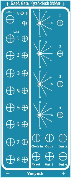

Hi
i have re-designed a panel i made a couple of years ago to incorporate the random gate circuit i've always wanted to build , i'm intending to up the dividers to 4 of and just have one clock input as that's the config i use most , both circuits on stripboard , hope to have it finished and running for the summer equinox with Epicyclus Very Happy
here's a jpeg save from corel draw 12 that i use for the panel designs.
i may change the rotary numbers to divison markings ,

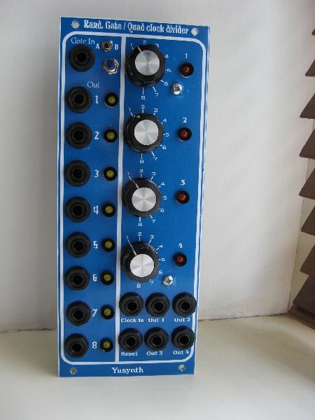

All wired now & attatched to the panel , very pleased Smile .
Dividers worked after a hair thin bit of solder found between tracks , working great now .
The random gates have a hiccup , but im on the case , i managed to source a SCL4006 chip , working on 1 & 3 not the rest, when i accidentally touched the 4006 pins the led's all flashed randomly then settled back to 1 & 3 , i've done the circuit on strip board , i'll re check everything before trying cricklewood uk for a CD4006.
still a couple of air bubbles to press out on the front .

PostPosted: Fri Jun 18, 2010 12:11 am    Post subject: Reply with quote  Mark this post and the followings unread
Are you using scotchmark for your front panel ?
Yves
Posts: 1220
Audio files: 159
PostPosted: Fri Jun 18, 2010 5:27 am    Post subject: Reply with quote  Mark this post and the followings unread
Hi Yves
i get my panels done at my local sign makers workshop , lazer printed blue onto sticky back white vinyl , using soapy water to de-activate the adhesive till it lines up with the drill holes and left to dry , the bubbles are fast contracting , almost flat finish now its had a few days to stick.
going to de-bug the random gates , i think it may be the SCL4006 chip ,
Dave..

PostPosted: Wed Jun 23, 2010 9:01 am    Post subject: Reply with quote  Mark this post and the followings unread
hurrah !!! , working now , fault caused by a rubber chip from ebay , date marked 1984 made in Tiwan , got a couple of chips from Crickelwood date marked 1979 and it's working like a dream now .
Chuffed to bits Very Happy
