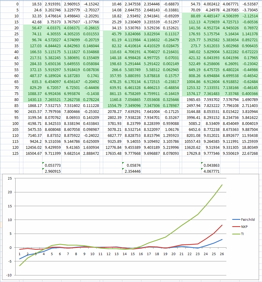

Done some testing of the tracking of some of the 4046 devices. I only have a Fairchild, NXP and TI parts. I used a Ruby script driving a MIDI interface and collecting the serial feed from a frequency counter. The results were then plugged into Excel. I took the natural log of the frequency and then did a linear fit over a reasonable useful range (the green bit) of about 50Hz to 1.5kHz. I then found the deviation from the best fit to give me some idea of the tracking... In an ideal world I would try and adjust for the best fit and then measure but I was to lazy to adjust each individually... Remember that the graph is logarithmic!
The TI part really doesn't cut the mustard... I did use this exact TI part in a very similar circuit that Tom designed for the VC Noise in the Synthesizer for the 21st Century and in that design it seemed to track fine? I will have to drag the board back out and check it again now...
see: http://forbinthesynthesizer.blogspot.com/2010/01/more-noise.html
The NXP and Fairchild Parts are very similar but I have found that the voltage that the NXP develops across the capacitor is quite a bit higher than the Fairchild so I have stuck to that part.
One of the datasheets that I found for the TI 4046 said that the design was from Harris (and so I suppose originally RCA). I am not sure how much individual variation there is some of the internal designs between manufacturers?

PostPosted: Thu Aug 05, 2010 3:13 am    Post subject: Reply with quote  Mark this post and the followings unread
Great work Forbin!
That is definitely above and beyond the call of duty. Very Happy

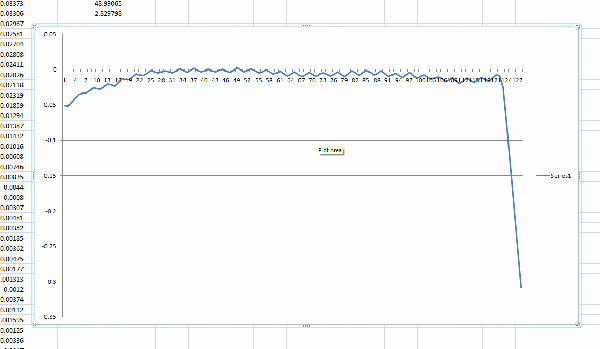

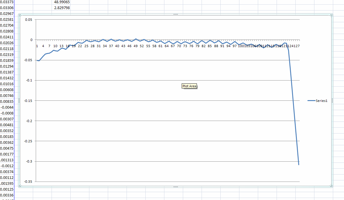

PostPosted: Mon Aug 09, 2010 3:05 am    Post subject: Reply with quote  Mark this post and the followings unread
This is probably getting a bit out of hand now but I am seeing ripple in the result when I increased the number of steps 0->10V. This was then a lot of testing of the MIDI interface and changing of DAC's -- this was improved things a bit...
