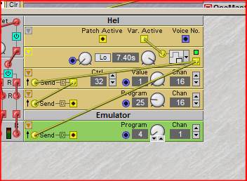

Here's how I do it. This sends a program/bank change to my second G2 (Hel), and another to Emulator X. I find that the delay needs to be about 2 seconds to prevent glitches in the receiving G2; I'm not sure why I set this one to 7 seconds.

thank you jamos, it looks exactly what I need. I'll try to patch this way tomorrow.
