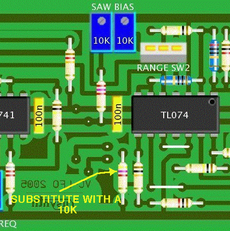

Hi, I have finished the sample & hold, but can't seem to trigger it, I have been using a saw LFO to trigger other modules, but doesn't seem to trigger the sample & hold.
I would like to keep everything in time (although I have no sequencer as yet) I'm presuming I need to build a proper clock circuit; where would I find one, or should the saw LFO be OK, and maybe I've made a mistake on the S&H clock in?
Any help appreciated

Does your circuit work when clocked from the internal oscillator?
Can you try a square wave for your external clock instead of a sawtooth wave?
Note that the LED should light up with an external clock. Does it light up for you?

Thanks for your reply, I get a faint glow on the LED (at best) when I use any sort of CV, but nothing seems strong enough to trigger it, doesn't matter where it's sourced from. I'm wondering if there's a way to increase the CV gain from the external input signals. Maybe a resistor is inhibiting this?
I'll investigate further, and report back with any findings.

The Sample&Hold circuit expects a positive SQUARE or a PULSE as an input. The sampling is triggerred by the rising edge of the PULSE.
You said that you are using a SAW LFO, a SAW is not recommended for this circuit because there is no schmitt trigger at the input. Check your SAW : if the stiff edge is a falling edge it won't work. If the stiff edge is a rising edge it should work. Try to reverse your saw.

Normally the clock input is expecting at least 5V (10V is better) to work properly. Normally the LED is shining mid-bright when externally clocked.

This would be the problem, I'm using your VCLFO 1&2, which only push out +3.4V / -3.4V. I guess I need to build a specific clocking device to run this externally, either that or somehow increase the voltage between the input socket and the board. What does everyone else use for clocking?
The output range of the VC-LFO 1 & 2 should be more than +/-3.4V . Are you powering them in +/-15V ? You should have at least +4.2/-4.2V
I have just check with my module and I have no problem triggering the S&H with the VC-LFO.
Yves

I use the MFOS wall wart adaptor which is 12V. Maybe I need a different supply for these modules, what would you recommend?

The circuit were designed for +15/-15 but can also work for +12/-12 if some resisto values are modified.
In your very case I suggest thtat you replace the 4.7K resistor at the output of the square signal by a 10K, the resistor is labelled R17.
MOD for +/-12V Power supply
