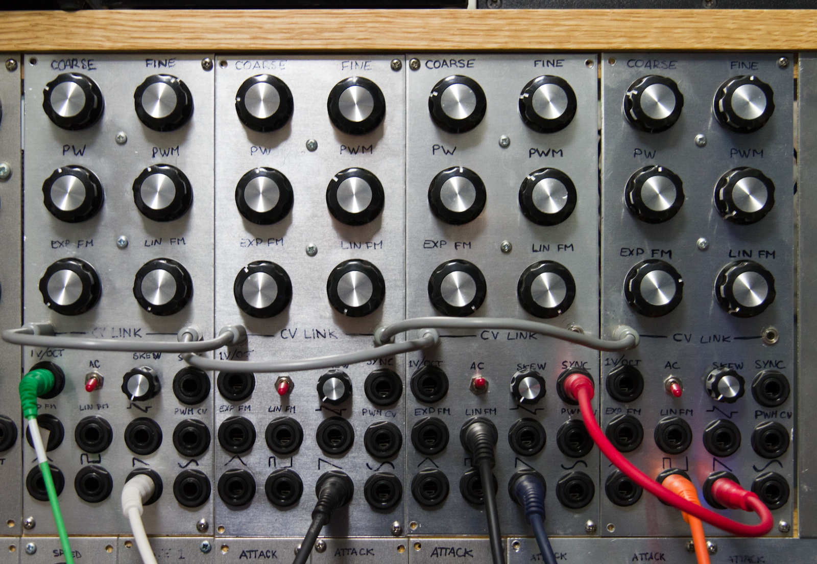

Here's my 'ghetto style' 4046 oscillators in 5U format. Thought you might want a look...
And here's the rest of the synth
Any more of these boards available?
Fonik's Oscillators :)
 Filesize:  1.3 MB
 Viewed:  498 Time(s)
PostPosted: Wed Nov 16, 2011 1:13 am    Post subject: Reply with quote  Mark this post and the followings unread
you built four of them and want more? so you are happy with them?
your synth looks great BTW - looks vintage...
and yes, i have PCBs available.

Indeed, they do everything an oscillator should, and track very nicely over a good range of octaves.
I'm in the process of moving, so now is not an ideal time to buy, but I'm definitely in for some more soon! Ideally I'd like another 8, but funds are looking more like I can only stretch to another 4 sets (I may come back for more at a later date).
Also, any plans for Fonik VCAs?
