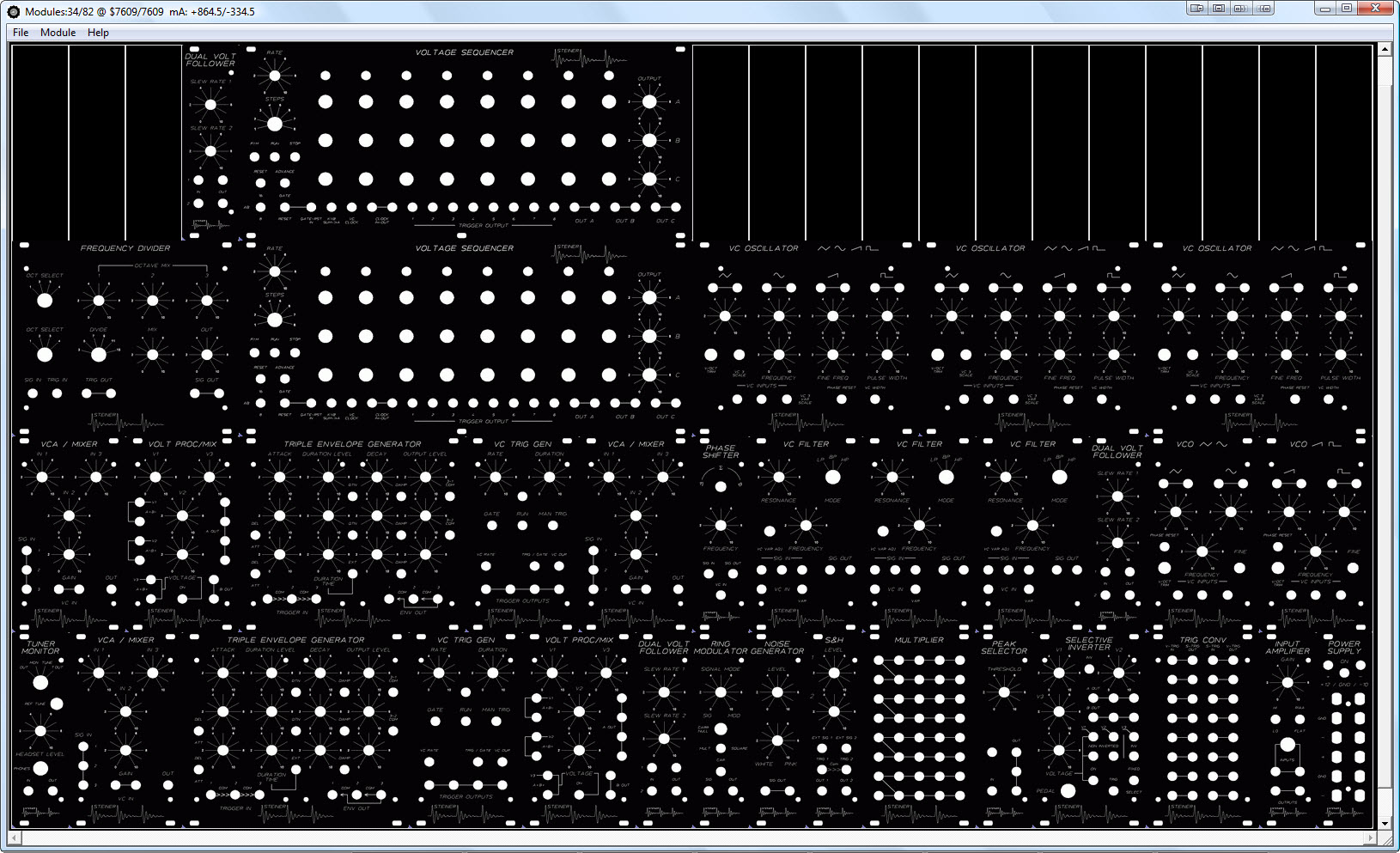

Hi everyone.
Sorry to be silent for some time, but I've been busy stuffing modules. I now have finished (waiting for final testing/calibration for a few of them):
1 x Frequency Divider
1 x Sequencer (I think I'll build one more of these. I love sequencers)
3 x VCO A
3 x VCA
2 x VPM
1 x EG (I am almost done with my second EG which will finish it!)
2 x VCTG
3 x Voltage Follower
3 x VCF
1 x Phaser
1 x VCO B Sine/Triangle
1 x VCO B Sawtooth/Square
1 x Tuner/Monitor
1 x Ring Modulator
1 x Noise with a pot between white and pink
1 x Sample and Hold/Random Voltage
1 x Multiplier
1 x Peak Selector
1 x Selective Inverter
1 x Trigger Converter (converts between S and Voltage triggers)
1 x Input Amplifier
1 x Power Access module (my design. just provides front panel for +12/-10 volts or +12/-12)

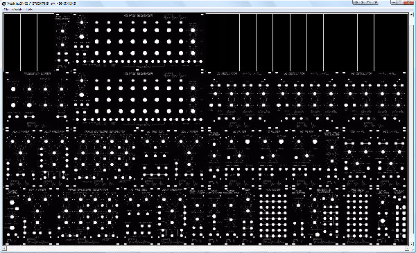

Using Algorithmic Arts old modular design software, I build a Steiner database and here is how I am going to arrange the modules.
I just have one triple EG to finish. I have the panel and flying wires ready to go. I just have to stuff the PCBs. This weekend I hope.
I've updated the web site, too. Fine tuned some of the calibration stuff, updated build notes, added some pages like a current status page, etc.
enjoy.
David

Using Algorithmic Arts old modular design program, I built this layout. I followed Nyle's Synthacon (not Synthasystem) philosophy of going right to left, so teh left hadn is free and closer to knobs that would more likely be tweaked.
