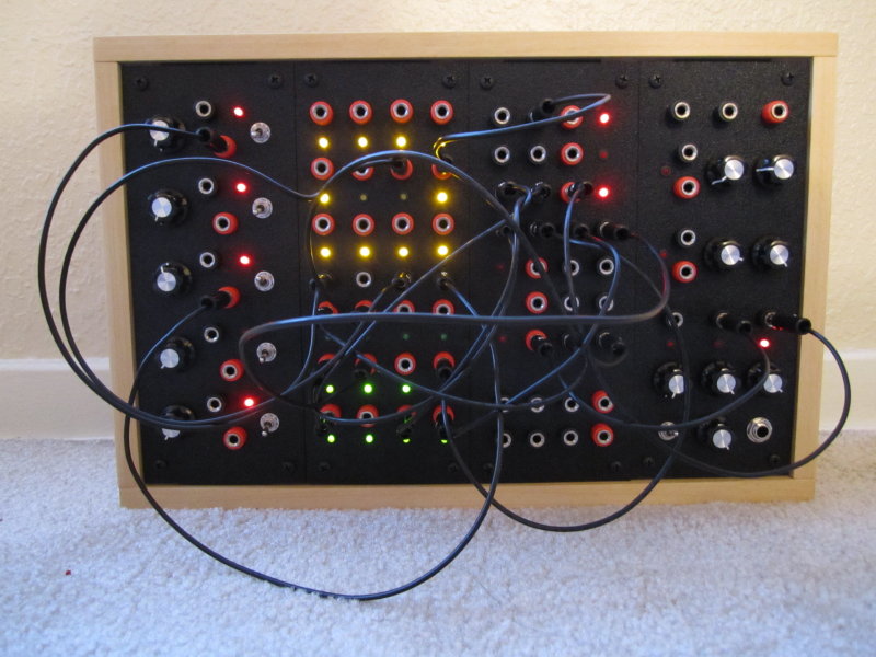

I just finished my CMOS sound machine using 6 of the chips from my Electronic Goldmine assortment. Here is a photo below. I'll post details on each of the chips and circuits in a separate thread.

I incorporated a few of the kit's ics into my main lunetta due to time constraints and some back issues which have slowed me down a tad. Here's my first track that utilizes the 4512 ic as well as the 4040. Essentially, the 4040 provides the inputs for the 4512 and a 40106 for 3 different oscillators for the ABC controllers on the 4512.
Some delay from my modded Danelectro BLT Slap Echo and mic input from my PWM ala Tim Escobedo were used. Track was recorded with no edits other than fade in and out in audacity.
If one of the goals of this thread was to get us building and sharing our work; mission accomplished Very Happy . The 4512 is my new "go to" chip that I am having a blast patching around.
