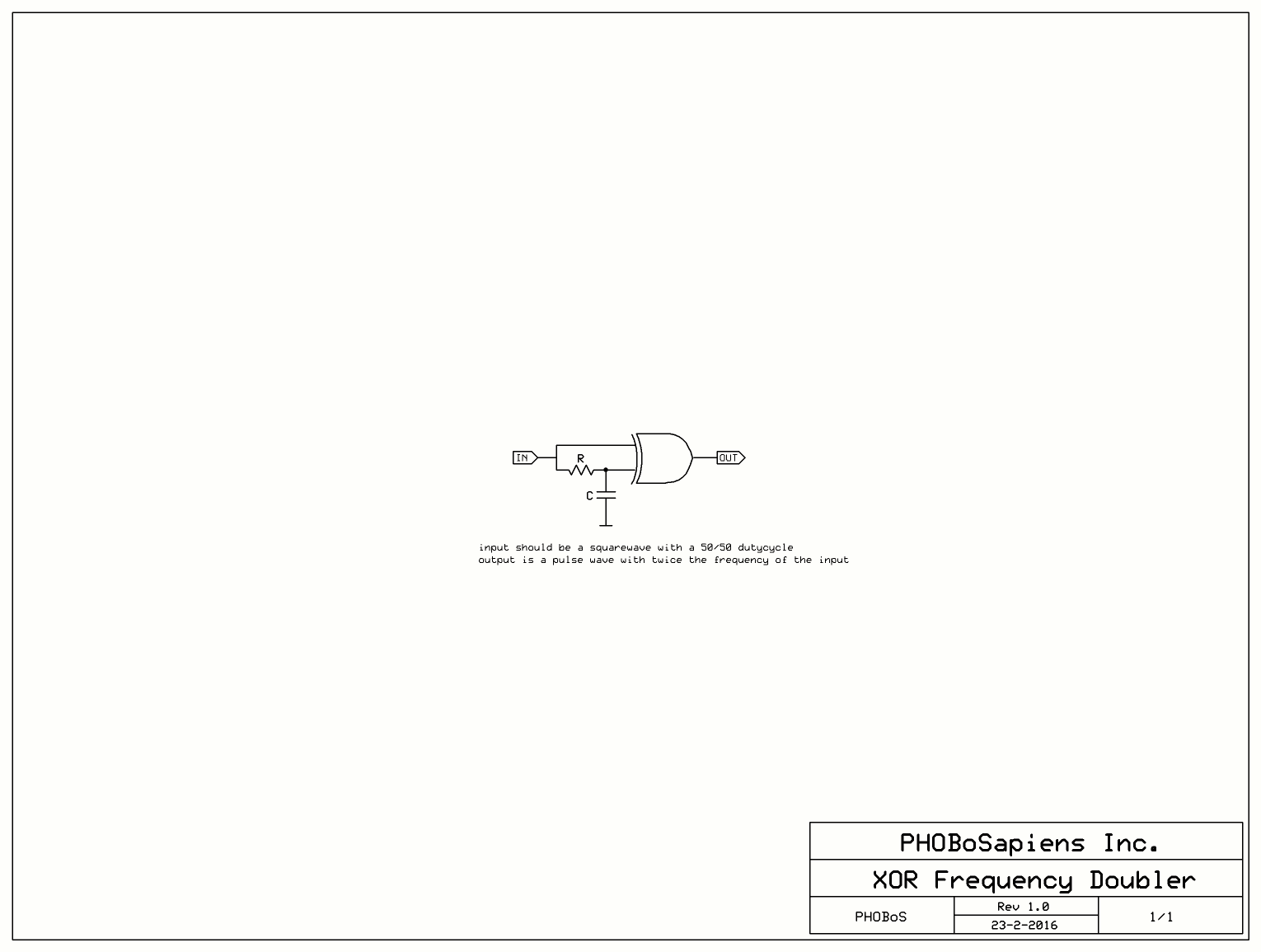

Cynosure wrote:
When looking at the RC combination of C1 R1 and C2 R2 the pulses at E and F calculate to about 2 usec! That might be to short.
Considering that 20kHz will be the max frequency out of the doubler, to be on the safe side a pulse of 50 usec should be the minimum pulsewidth.
That calculates to about a capacitor of 560pF.
(for this I assumed that the output impedance of N2 = 0 ohm and the input impedance of N3 and N4 are infinite and the schmitt trigger trips at around 1/2 Vcc).
Check for yourself
Posts: 5883
PostPosted: Tue Feb 23, 2016 7:33 am    Post subject: Reply with quote  Mark this post and the followings unread
This might work as a simple doubler. (it's a variation on my XOR Pulse Width controller).
XOR frequency doubler

L´Andratté
Joined: Sep 23, 2012
Posts: 151
Location: Hamburg, Germany
PostPosted: Tue Mar 01, 2016 12:32 pm    Post subject: Reply with quote  Mark this post and the followings unread
There´s the slacktave design on diystompboxes, that I have built, which uses the same snippet for frequency doubling and it works very good!
