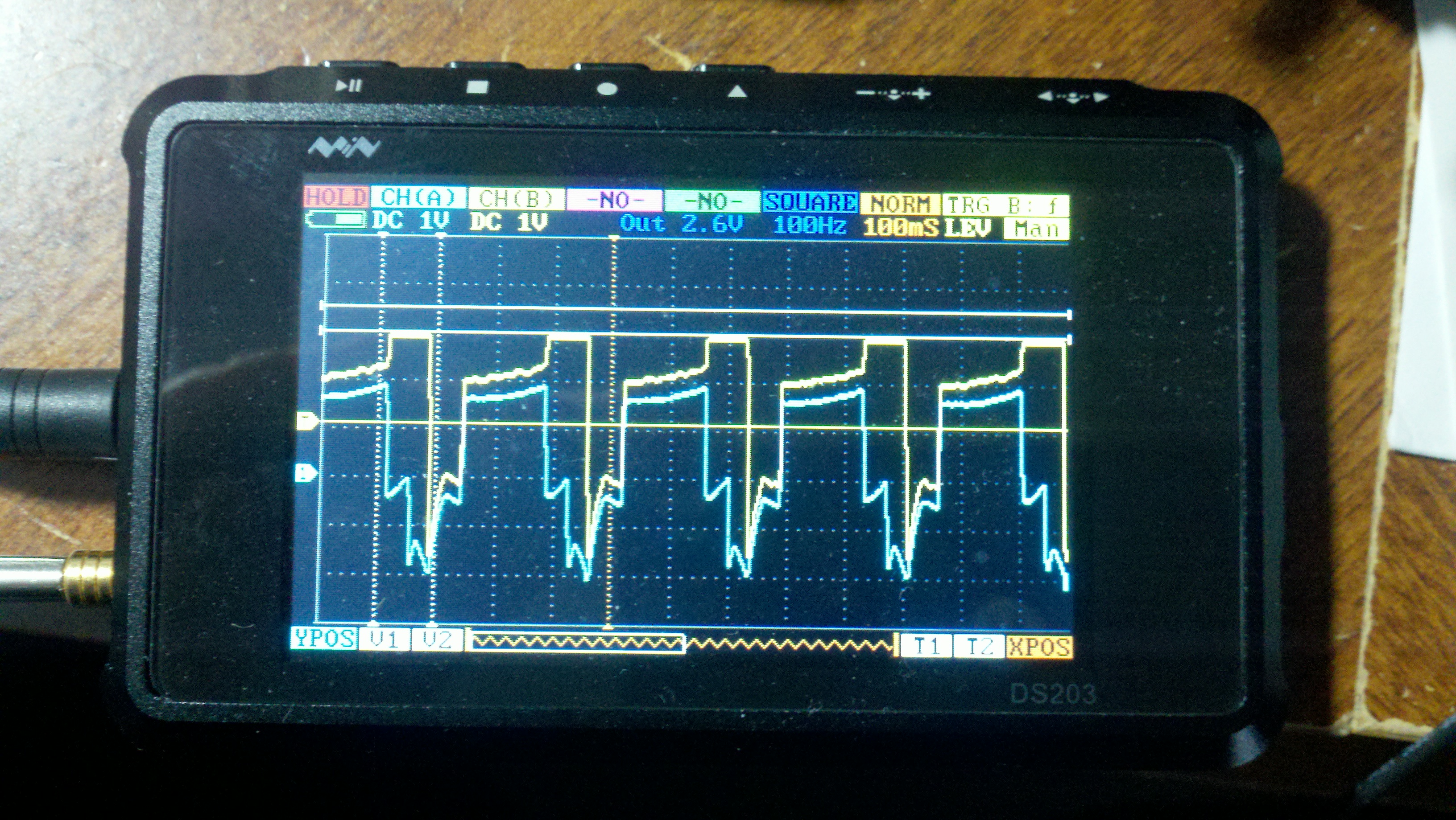

PostPosted: Sun Mar 03, 2013 8:09 pm    Post subject: AAArrg Reply with quote  Mark this post and the followings unread
This is what it looks like if you short all your inputs and outputs together because you wired all the two pin connectors backwards
I'm going to take the lazy man's out and turn the pin connectors around instead of wasting all these (press in type, so they aren't easily reversed) sockets. And I don't think I want to switch so all my green wires go to the tips, cos that will confuse the hell out of me at some point in the future too.
For the record, I am no longer ordering the press in type of sockets, I just ran out of the crimp pin sockets and had these available....
Edit: yellow is pin 3 of the 555, blue is what all the outputs looked like.
