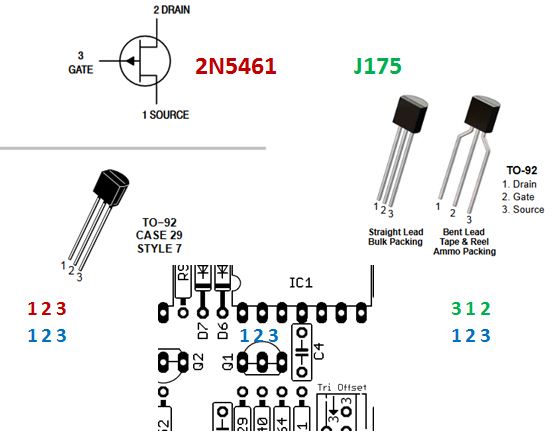

any news on equivalents for the 2N5461 ?
have some 2N5460 , but they are built for lower voltage , ?

PostPosted: Wed Feb 27, 2019 10:57 am    Post subject: Reply with quote  Mark this post and the followings unread
The 2N5461 N-channel is obsolete today.
But one could use the J175, however, it has a different footprint which makes the mounting a little bit fiddly.
here is a picture that shows the different pin-out and how it corresponds to the PCB:
