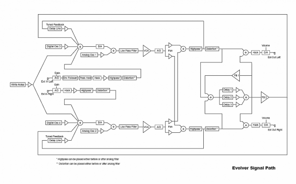

Actually I have just been looking into it a bit and am wondering about the oscillators.
Are they maybe digital, or maybe 2 analog and 2 digital like the evolvers, there doesn't seem to be much info on them.

Ah! I think you're right. From the specs:
"Each voice features four oscillators capable of generating classic and complex waveforms,..."
That, and Dave Smith saying in his presentation video that he took the best from the Evolver and Prophet 08, indicates that this may be 2 x DCO and 2 x wavetable oscillators. Now, that might not be a problem - IMO the most important analogue part is the drive->filter->amp chain.
With the delay section in each of the 12 voices, the mixdown is probably digital too - I doubt he does AD->delay->DA per voice into an analogue -mixer, like for the 4 voice evolver with it's 4 separate stereo voice outputs (i.e. I have further doubt about there being 12 separate stereo voice outputs). Anyway, he doesn't claim a 100% analogue signal path, like for the Prophet 08
Evolver block diagram attached for reference. BTW, that diagram was taken down from the DSI site many years ago. Some analogue zealots got angry when faced with the fact that it wasn't an all analogue path (which was a popular belief that DSI most likely was happy about letting continue Wink), but a ca. 80% digital / 20% analogue synth. Not that there's anything wrong about that for us who tolerate hybrid synths and mixed architectures...

From another forum, reported by a guy who visited the DSI booth at NAMM:
"The oscillators are virtual, produced by a total of six SHARC chips. Output is then converted to analog to go to filters and VCAs. The chips also handle effects."
Now you guys know why the ad mentions analog VCAs, analog filters, etc. but no analog oscillators. It's a hybrid... To me, this isn't necessarily a negative, because I'm not one of those people who feels a synth has to have analog VCOs to sound good (hell, I own a Nord Modular G2X Laughing ). It has potential to sound good in the right hands, imo.
I respect Dave Smith so much for his contribution to synth history, but he is nowhere near as good at demoing his own gear as Amos is at demoing Moog's. The difference between success and failure for this synth is an awesome demo - hopefully Sonic State will get there before NAMM closes.

Cool! Six SHARCs - that's exactly the same as in a Solaris. A healthy amount of computing power. And a good thing; it means that oscillators and so on can easily have more features than in an all analogue implementation.
With reference to my previous posting, I colour coded the functional blocks in the Evolver block diagram by signal domains: green = analogue, blue = digital, orange = mixed signal. This should indicate that "a bit" (80% of it) of digital isn't necessarily bad, especially as it has the approval of many of the most outspoken of the "pure analogue crowd" Very Happy
