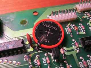

I just got a Yamaha DX7 from a guy who was literally on his way to the dump with it. The keyboard powered up but wouldn't play sounds normally just little garbled squeaks and noises. The battery check showed 2.3 and he said he was the original owner and had never changed it and that the DX had been in his closet for quite some time. It came with 2 DX7 voice ROM cartridges(3 Master group, Keyboard and plucked group and 4 Orchestral and percussive, Complex and effects group.) a Data RAM cartridge a Chismark Fourplay cartridge(Reads invalid format when inserted) and a Red Planet Instruments SR512 that goes in the cart slot though I have no idea what this does). It also came with a nice Yamaha sustain pedal(piano type) so pretty good score. I took it home and gave it a once over. It is clean on the inside and everything is operational except the internal sounds wouldn't play. After doing some research I concluded the battery needed to be replaced so I ordered one from Yamaha. I'm pretty good with a soldering gun and after taking apart and fixing my Roland D-50 was ready to do the fix. I replaced the battery with + and - placement correct and put the whole thing back together in no time. See photo attachment.
Howeverrrrrr. 8O Confused
I turned the DX7 on and it displayed "Memory Protect- Change Battery!" Ummm well I DID change the battery so why is it telling me to? Laughing Rolling Eyes then going to the internal bank it still had the same problem with the internal voices with wrong patch names displayed next to say INIT 3 so at this point I'm thinking patch corruption. I turned memory protect off then used a ROM card and loaded it into the internal bank. The sounds were there but I had to reprogram patch characters like the pitch and mod wheel so they would sound right finally getting all the sounds correct. I turned memory protect back on but found that if I unplug or leave it off overnight the sounds are lost and I have to do all that again. Checking the battery it sometimes shows different readings(which I've heard is common with DX7s) even as low as 0.8 and as high as 4.2.
So now I'm thinking either Yamaha sent me a bad battery or it's something else entirely? Does the positive tab on the battery have to be folded over onto the motherboard like the original one was to make a suitable connection?
Also making my life more difficult is that for some reason my voltmeter all of a sudden just doesn't work.
Any help would be great. I've read though some of the posts here and it's given me a good understanding this issue but since I've replaced the battery with a new one it should hold sounds and settings in memory....and it's baffling me.

I just took a DC reading and the battery checks out as being good. The battery has a + and - post and they simply fit into 2 tiny holes on the motherboard and then soldered so that it stays put but the battery that I removed had the + tab folded over onto the MB...which I didn't do for fear of breaking the post...I just soldered it in place thinking this was all that's needed. So now I'm wondering if it was something I did wrong.
From what I understand the factory reset with a DX7 is either reloading the factory settings from the data cart(I don't have that one) or by sysex...but I'm still not exactly sure.

Hey thanks for the reply....the Battery was purchased from Yamaha and it comes in the holder. It is the one specifically for the DX7. We're all set on that.
The problem is I've twice soldered the Battery and I still keep getting a "Change Battery!" alert in the display each time as if there was no battery.

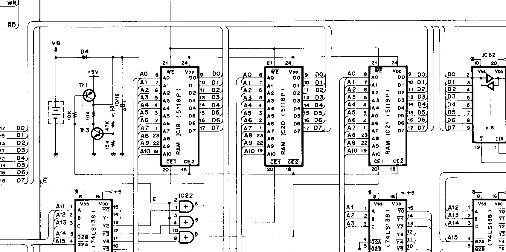

go here and look at the circuit diagram(schematics)
http://homepages.abdn.ac.uk/mth192/pages/html/dx7.html
go to page 3
Here you will see the battery and D4.
With power OFF measure from the D4 anode to ground.
You should get the full battery voltage. (~ 3VDC)
Now measure from the D4 cathode to Gnd. You should get a voltage drop of .5 to .7 volts DC (2.3 to 2.6 VDC)
Next measure from IC19 pin 24 to Gnd. Voltage should be the same as D4 cathode to Gnd.
Next measure from IC20 pin 24 to Gnd. Voltage should be the same as D4 cathode to Gnd.
Next measure from IC21 pin 24 to Gnd. Voltage should be the same as D4 cathode to Gnd.

I'm looking at the schematic diagram...I see the RAM chips but I don't see the battery or the D4 which page of the schematic is it on?
Should I check voltage with the board in place and the unit plugged in?
In the pdf file my viewer shows it at page 3.
The battery, D4, IC19, 20 and 21 are clearly marked.
NO, you do not want power on. Yes the PCB should be in place.
What you are doing is checking to see that the battery is providing the Voltage needed by Memory to hold the info.

Thanks for the closer view I can see the little D4 cathode tube and the RAM chips.
This checks out and the voltage is ~ 3VDC from the pin that comes out of the top of D4 that connects to the board.
Here I'm not sure where to measure voltage and just what is the cathode and diode. I tried under and directly on the tube and ground and get a small fluxuating reading of -1 to +1.
I'm getting voltage of 3.04 on all 3 of these. Maybe I'm not doing this right?

"This checks out and the voltage is ~ 3VDC from the pin that comes out of the top of D4 that connects to the board. "
Measure from one side of D4 to ground. If you can make sure it is the Anode side. You should get ~ 3 VDC.
Next measure the other side of D4 , the cathode, identified usually by a black or colored band on one end. This measurement should be about 2.3 to 2.5 VDC.
The measurements one each side of D4 should NOT be the same. You need to see a voltage drop.
I'm getting voltage of 3.04 on all 3 of these. Maybe I'm not doing this right?<<<<<<
You should not be reading 3 VDC here . You should read a voltage drop of at least 1/2 VDC, so you should see around 2.5 VDC here. From your measurements, it looks like D4 is shorted. You can check this with an Ohmmeter.

I'm guessing the anode side is the metal pin that juts out of the top of D4. This is where I get ~ 3 VDC.
It's a small tube with a blue colored band. Here I'm getting
~ 3 VDC at the very base of D4 if I'm measuring it right. The thing is so tiny.

Gothboy
it looks like your diode is shorted. Did you measure ohms across it?
You need to see a voltage drop across the diode. You are not getting it.
When the synth is not powered .. otherwise it could be a voltage rise too.

pdman1 wrote:
Gothboy
Well I hear you. What I don't get is if that is true why was I not getting the "Replace Battery!" error until I put the new battery in? With the old Battery measuring 2.3V I didn't get this error in the display. The D4 cathode looks fine to me...if it's shorted does it change in color or turn black or something?
Is the D4 replaceable?

pdman1
Joined: Mar 28, 2007
Posts: 50
Location: North Shore Massachusetts
PostPosted: Tue Feb 26, 2013 5:06 pm    Post subject: Reply with quote  Mark this post and the followings unread
gb
do you have a meter?
Can you measure ohms?
With power off measure for ohms across D4 to see if it is shorted. Alternately you could use the diode check function on a DMM as well.
No, the band does not change color or anything like that.
If you are unsure on how to use a meter or make measurements, use google to find a tutorial.
Also you could use a Friend or someone that has some experience to help you out. Where are you located?
Yes D4 can be replaced.

Gothboy wrote:
pdman1 wrote:
Gothboy
Not sure why your getting the error other than somehow something is shorted or open caused by the repair. Is the PCB double side? Maybe a via (feed through) was damaged when the battery was unsoldered.
How did you unsolder it? With wick, solder sucker, vacuum solder station, etc?
