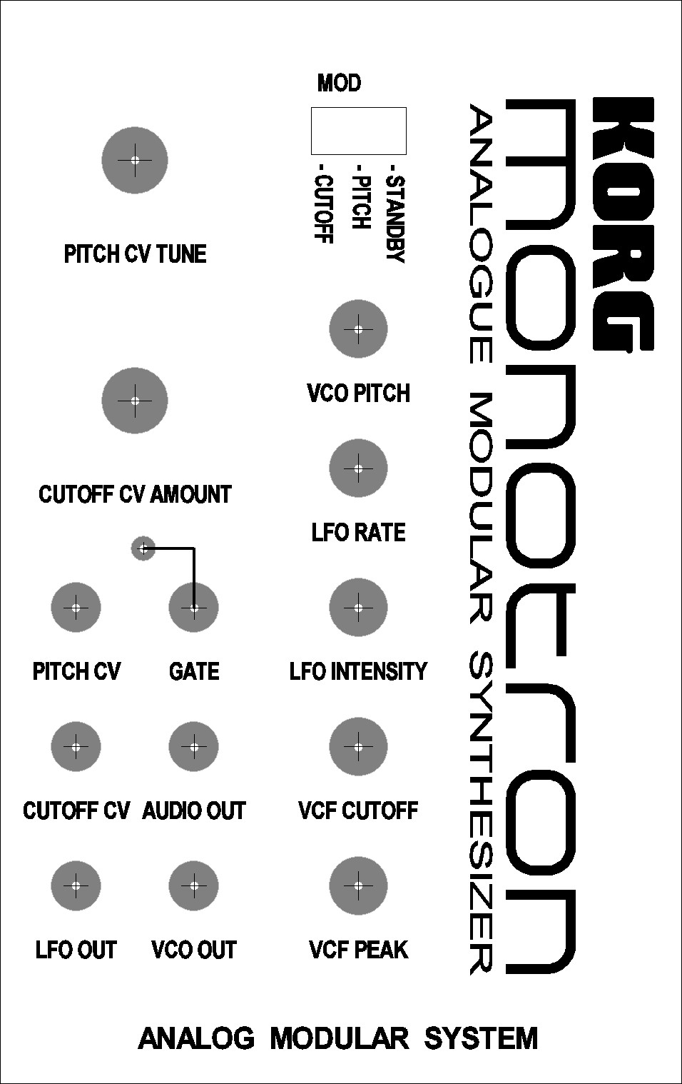

I finished the artwork for the aluminium front and is in eurorack format.
Two layouts i designed, one with the sub'd connector and one complete
with the Monotron. (no ribbon controller)
THESE ARE THE RAW VERSIONS !!
When i have all the parts, a final check.
Grt.
Chris

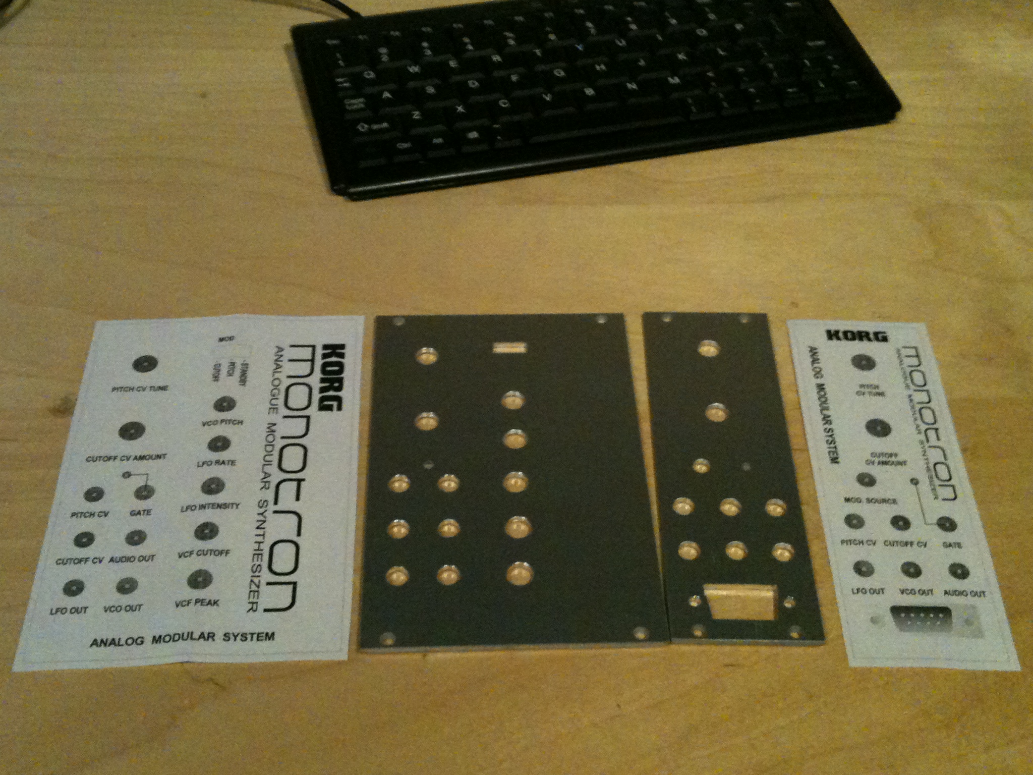

KRS1972
Joined: Sep 27, 2012 Posts: 38 Location: Amsterdam
Posted: Sun Mar 10, 2013 8:16 am Post subject:
Today i finished the front panels.
Art layouts are ok, sub'd connector a little bit higher so it fits better in the eurorack.
My second Monotron arrived for the other front panel.
The ribbon controller i will use later.
Here some pictures.
Grt,
Chris

| How did you make that good looking panel? |
KRS1972
Posted: Mon Mar 11, 2013 1:40 pm Post subject:
For my eurorack front plates i always use anodized aluminum.
The artwork on the panel is done with "waterslide decal paper", you can get it for laser and inktjet printers.
After that i spray a thin layer of vernish to finish it.
Grt.
Chris |

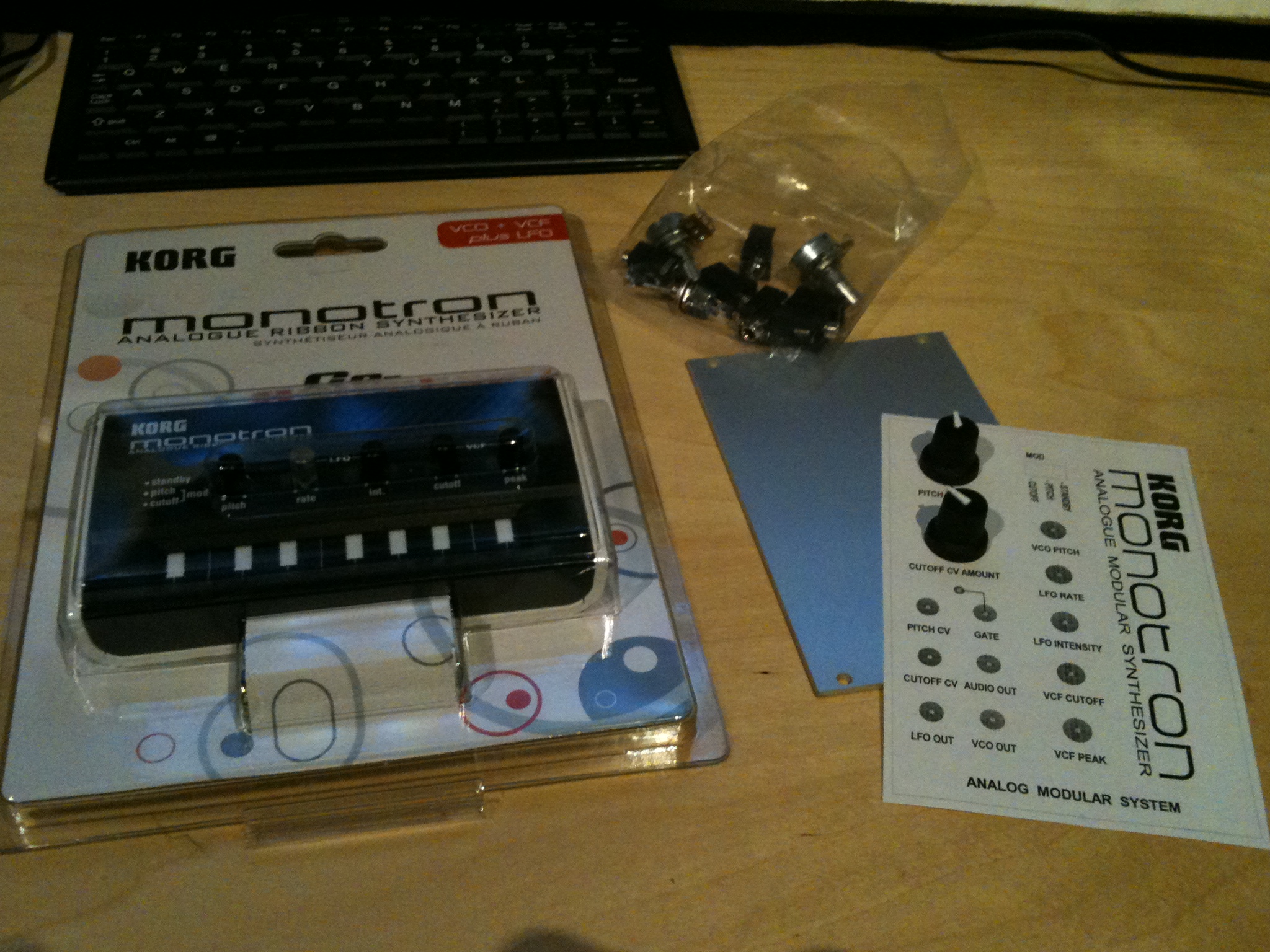

KRS1972
Posted: Wed Mar 13, 2013 2:05 pm Post subject:
Here some pictures of the second panel with pcb from the Monotron, pots and jacks.
Grt,
Chris
