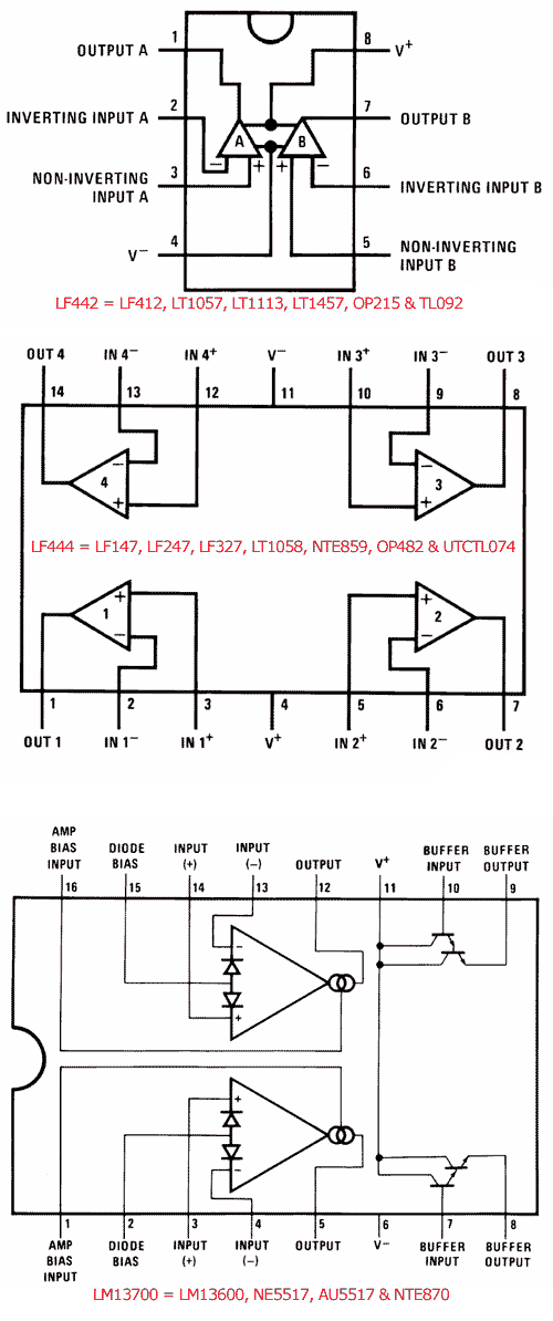

Hello all i just had some extra time so i made list of the substitutes for Sound Lab IC´s. hope this is useful to somebody.
first there is LF442 (Dual JFET input op-amp)
at least the following IC´s share the same pinouts and therefore can replace LF442
LF412
LT1057
LT1113
LT1457
OP215
TL092

Second comes LF444 (Quad JFET input op-amp)
at least the following IC´s share the same pinouts and therefore can replace LF444
LT1058
LF147
LF247
LF347
NTE859
OP482
TL074

Third comes LM13700 (dual Operational Transconductance Amp)
at least the following IC´s share the same pinouts and therefore can replace LM13700
LM13600
NE5517
AU5517
NTE870

and then there is
MPF102 (N JFET Amplifier)
this info is gathered from other post
so try these:
2N5457
BF256A
PN4416
J202
2N5951
2N3819
http://www.alldatasheet.com/datasheet-pdf/pdf/11484/ONSEMI/2N5457.html
http://www.alldatasheet.com/datasheet-pdf/pdf/77365/MOTOROLA/BF256A.html
http://www.alldatasheet.com/datasheet-pdf/pdf/18727/PHILIPS/PN4416.html
http://www.alldatasheet.com/datasheet-pdf/pdf/53143/FAIRCHILD/J202.html
http://www.alldatasheet.com/datasheet-pdf/pdf/50023/FAIRCHILD/2N5951.html
http://www.alldatasheet.com/datasheet-pdf/pdf/15075/PHILIPS/2N3819.html
NOTICE that the pins are oriented differently so make sure you insert it into the circuit board correctly.

More LF442 replacements: TL072 (low noise), TL062 (low power)
More LF444 replacements: TL064 (low power)
TL082 and TL084 are also options.

Pehr wrote:
Does anyone know if the LM324 is a good substitute for LF444? Confused
LF444 is a JFET input opamp, LM324 isn't. So no.

Just a little warning.
You can't always substitute 13600 for 13700. 13700 have linearisation diodes, 13600 does not.
If Rays design uses these diodes you can NOT use the 13600 in stead of the 13700.
I do not know if this is the case though.
