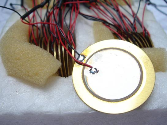

i don't´know how to get hand´s on piezos i found my piezos in some old pillow speakers... but i think there are piezos just everywhere
im sure you have seen these disk´s inside somewhere
daniel
