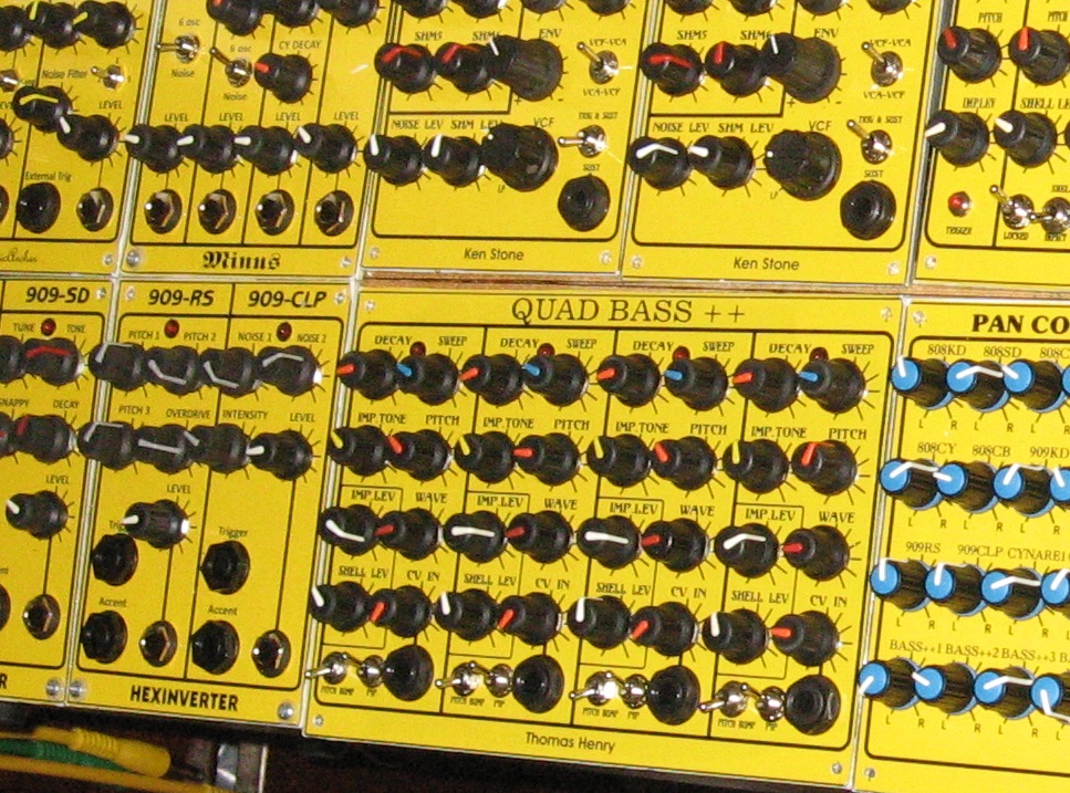

And also got the Quad-BASS++ finished too Smile after a battle with finding a little slither of copper between tracks on my veroboard daughter board for the pitch bump & wave mods , got it though and working now Smile .
That's all the sound making panels loosly fitted in place in the case, now the long list of snagging jobs to do (wrong direction pots , couple of volume level increases & wire the FX send rotary switches to the modules that don't have an audio output jack on their panels.
Dave.

A bit of info about the build...........
Top Row Left..
808 kick & snare :- Eric Archer layouts + some mods
808 HH's / Cymbal / cowbell :- Minus layouts on electro-music.
http://www.ericarcher.net/
http://www.electro-music.com/forum/topic-54826.html
http://www.stereoping.com/e-drums/?lang=en
By studying these pages and the 808 service manual I was able to cross reference between them to help me lower the tuning of the kick and extend the decay a little on the snare & cymbal.
2X CYNARE :- as the original CGS47 cynare with the 6 shimmer control pots brought out to the panel.
http://www.cgs.synth.net/
Mega Percussive Synth :- Got these in 2009 standard build without inserts .
http://www.birthofasynth.com/Thomas_Henry/Pages/MPS.html
Bottom Row Left.....
Nein oh nein :- as per purchased pcb kick, snare , rimshot, claps, with all the mods done in the documents.
http://cv.hexinverter.net/?page=projects&id=neinohnein--kick-drum-v10
Quad Bass++ :- as the original plan with bump mod and Wave mod.
http://www.birthofasynth.com/Thomas_Henry/Pages/Bass_Plus.html
http://www.electro-music.com/forum/topic-53420.html
http://electro-music.com/forum/topic-40457.html
Pan Control :- all the modules have their own volume out controls, the outputs from each module are wired in screened cable to this panel's veroboad circuits , nearly all the voices were reasonably balance in level , only a couple of drum sounds needed a little pre amp to boost.
Mfos oldies but goodies pan mixer
http://www.musicfromouterspace.com/forums.html?MAINTAB=SYNTHDIY&PROJARG=OLDIESBUTGOODIES/AUDIOMIXER/panningmixer.html&VPW=1124&VPH=500
FX and mixer :- Hexinverter battery acid CV , compressor & MXR distortion built as per document & pcb , stand alone FX
,Drum voices or external sounds / instruments can be pluged into it.
http://cv.hexinverter.net/?projects=batteryacid-cv-diy-version-of-idow-edition
Mfos cv panner speaker simulator , the outputs are hard wired to the stereo bus , input level is set with a trimmer on the pcb it is set for the drum modules levels only.
2x Mfos CV echo , built as per design & pcb , these are both stand alone FX (in & out jacks).
http://www.musicfromouterspace.com/forums.html?MAINTAB=SYNTHDIY&PROJARG=STEREOPANNER/STEREOPANNER.html&VPW=1124&VPH=500
http://www.musicfromouterspace.com/forums.html?MAINTAB=SYNTHDIY&PROJARG=ECHOFXXX/ECHOFXXX.php&VPW=1124&VPH=500
The two rotary switches are FX sends for the modules that don't have an audio output socket on their panels , rotary 1 handles Bass++ 1,2,3 & 4.
Rotary 2 handles Cynare 1&2, MPS 1&2 , both selectors send their signals through a unity gain buffer to the single socket under their dials ready to patch to FX .
The little 5 channel pan mixer above those acts as FX returns to the stereo bus or plug an external instrument in if needed or the returns from an external FX unit .
That's my brain empty of drum info now , I'm off to programme some demo patterns Very Happy Very Happy
Dave.
