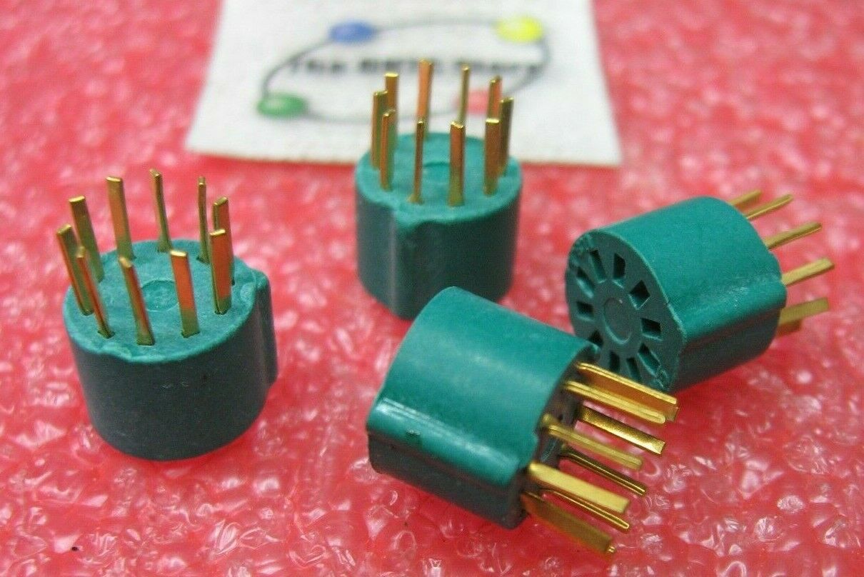

https://www.ebay.com/itm/143981901715

Thanks for the link to the sockets.
Of course correct me if I'm wrong but your explanation reads a little like "if it's there do leave it there, and if it's not there don't add it", therefore I don't really feel the need to say it, so why would you mention it ?

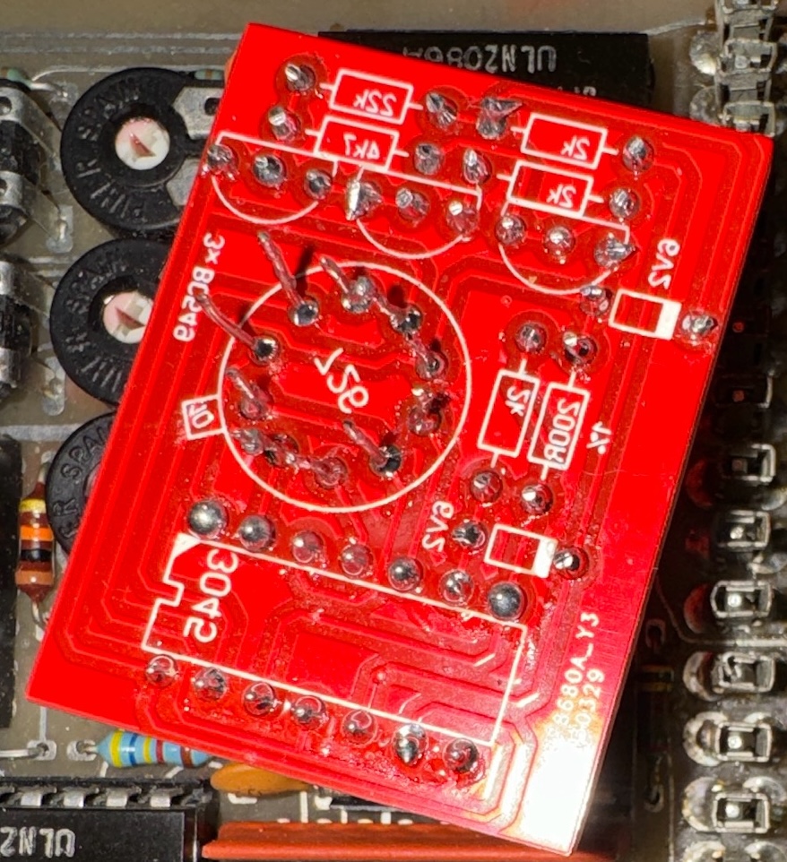

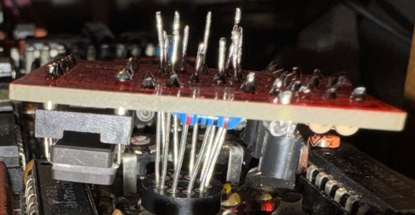

[quote="mikefiction"]
LeBon wrote:
Isn't this backwards?
Meaning it looks like the board would be installed component side down.
From the top, the ua726 pins go 1-2-3 etc counter-clockwise but this replacement board looks like it's 1-2-3 etc clockwise. If the component/silkscreen side is installed facing up, it looks like only pins 10 and 5 would be correct. Hope that makes sense.
I noticed it initially because the ua726 NC pin 7 is pin 3 on this PCB looking from above.
You are probably right as I tried it and so far it doesn't fully work. I'd be really interested if some of you could understand what is wrong and offer a fix...
 Filesize:  356.61 KB
 Viewed:  183 Time(s)
 Filesize:  498.31 KB
 Viewed:  215 Time(s)
mikefiction
Joined: Jan 23, 2013
Posts: 3
Location: Circleville, OH USA
PostPosted: Sun Mar 24, 2024 7:03 am    Post subject: Reply with quote  Mark this post and the followings unread
Your whole PCB looks like it was mirrored when created? I'm not familiar with Sprint as I use Diptrace, but I downloaded the demo to view the PCB. Did you accidentally check the 'mirror' option when you exported to gerber? That would explain what I'm seeing.
Comparing the schematic and referencing the datasheets of both devices everything else looked ok, just the pinouts of the ua726 were mirrored in the original. I've redrawn the board in diptrace and sent them off for fab, then noticed that error - corrected it and resent the new version off to fab. We'll see how it goes Smile
I also condensed it's size a little bit and i'm sure that could be optimized further too if this works.
I also noticed the schematic specifies BC546 and the PCB says BC549 - I'm not sure which is correct and haven't looked at the datasheets to see if it even matters yet. I'll check into that next.
nuipb
Joined: Oct 06, 2009
Posts: 49
PostPosted: Sun Mar 24, 2024 11:58 am    Post subject: Reply with quote  Mark this post and the followings unread
I see what you mean and as far as I was aware of it I didn't "mirror" the drawing. Of course I could have made a mistake that day but doubt it. However I certainly hoped after delivery that the traces would be the other side around at least, so that the parts remain accessible.
I also thought of condensing the PCB once it fully works. My first suggestion would be to reduce the diameter of the UA726 imprint and make it the same diameter as the original. The current diameter is quite bigger and is a pain to assemble...
I'm certainly interested in your results. Please do keep us informed !
