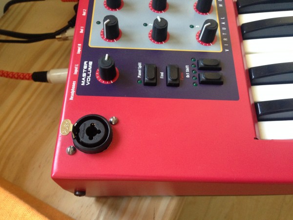

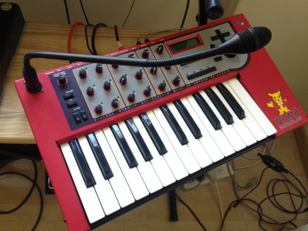

It's been a while since I posted this, but I realized someone might be interested in a similar mod and my experience might help. Finally, I decided to drill my synth (ouch!), attaching an XLR connector to the front, adding an internally wired preamp and normalizing its output to INPUT 1 (anything connected to this input would leave the mic out of the circuit). The microphone I used is a dynamic Audio Technica AT808G.
I built this simple transistor based preamp: http://4.bp.blogspot.com/-vtwAWSTUFso/UqgAlA8qMnI/AAAAAAAAAPM/3ZZ7h3syQlA/s1600/Circuit+1.bmp which takes its 5v supply from the synth itself (the power supply PCB in the NM is clearly labelled so it's easy to find a point to connect the preamp).
Before drilling, make sure you detach all boards from the panel. My drilling wasn't as neat as I'd like, but I guess it's not that bad.
I had to replace the INPUT 1 jack and wired the preamp output to the normally closed lug.
The preamp board is so tiny, mine rests hot-glued to the connector.
Another idea is to use a combo connector and make an instrument preamp as well, to be able to conect the mic or a guitar. I haven't found a circuit suitable for 5v operation still, and don't know what to mod in this preamp for it to work on instrument level, but I'll eventually do it.
Audio quality is definitely not hi-fi, but the noise floor is pretty decent. And it sure works great for vocoders. Some gain and a gate in the patch make it work like a charm.
