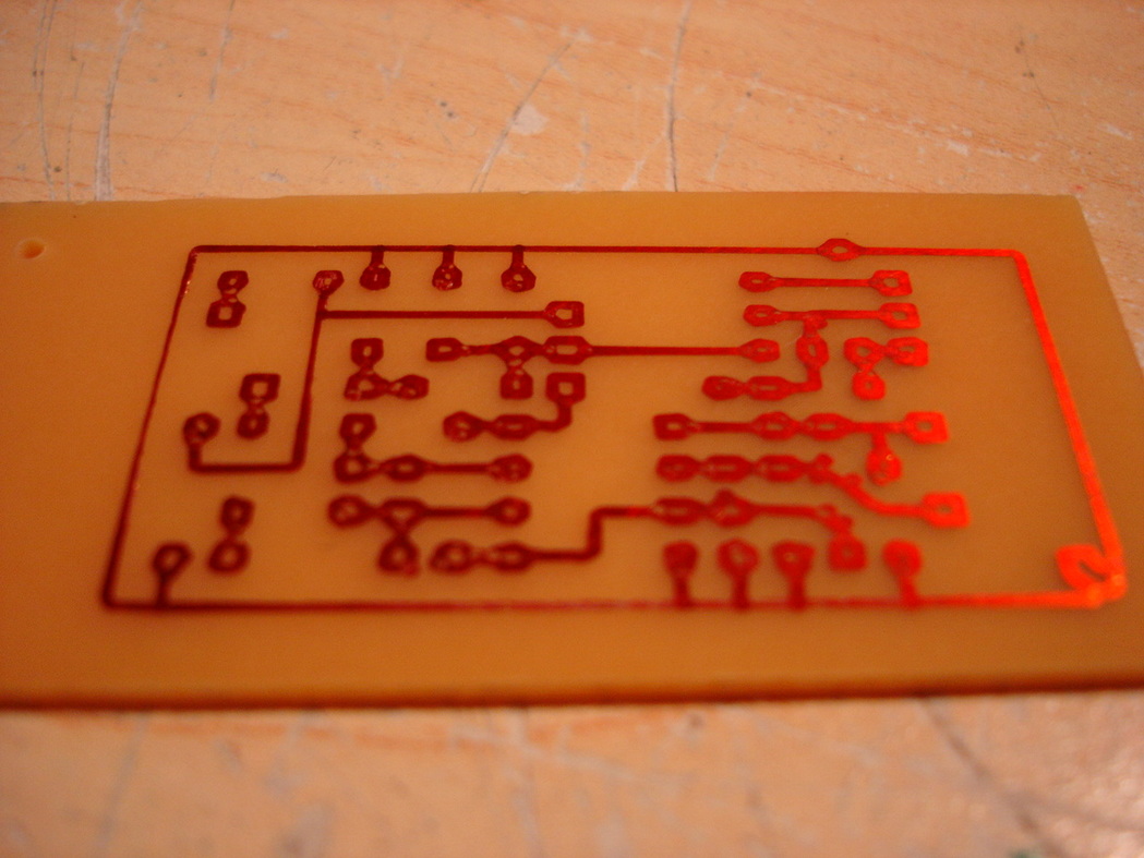

I never tried the UV method but I really hated the PNP method. Either the results were perfect or absolutely terrible. I did try a different method that I found online using an old XY plotter. Needless to say I'm amazed at the results. The link is: http://www.willcoxonline.com/PCBplotting/main.html and trust me, it rules. I plan on doing the wacky synth pcb in this manner. So far I've done a few various boards, here's a pic of one of them.

I use Press'n'Peel blue constantly, so I recently took to buying 100packs from the supplier in the US - that is a lot cheaper than maplin but also cheaper than the cheapest UK supplier I know (go for this place rather than Maplin anyday -- should be good for the rest of europe too) (small friendly place too..): http://www.ronlin.co.uk/ - don't think you'll find a cheaper small quantity supplier around here...
I got a laser printer for about £90 new (but the downside is that a toner cartridge costs £40 to £60 (depending on capacity) - though there's a cheaper refill now available for the particular model) - its not the best printer so I sometimes get some bad patches and a few smudges - but easy enough to tidy them up.. I always print at 600dpi and that resoluton is fine.
There's always the risk of the toner not sticking to all parts of the copper board - I've done loads of sheets of P'n'P and still its quite hit-or-miss as to whether the final result is acceptable or whether I have to start again.. Depends on the complexity of the layout.. But if its only a few areas slightly dodgy then I tidy it up with one of these pens (available from maplin or cheaper at www.rapidelectronics.co.uk
((these work sooooo much better than those cheaper cd black marker pens))
Until recently I was using ferric chloride in an old photo tank.. Messy..
But now I use something from Maplin (..so, after all my bad feelings about them, there's still some (a very little) good in store there..!..) that is cheap and great:
Maplin Etch Tank only £39.99
This is now sooo quick and somewhat less messy (still the ferric chloride does get everywhere..) - - the tank bubbles and heats so boards are ready really quickly...
Final thing to quicken the process is a drill-press that I got a car boot sale with a cheapo rotary drill in it.
