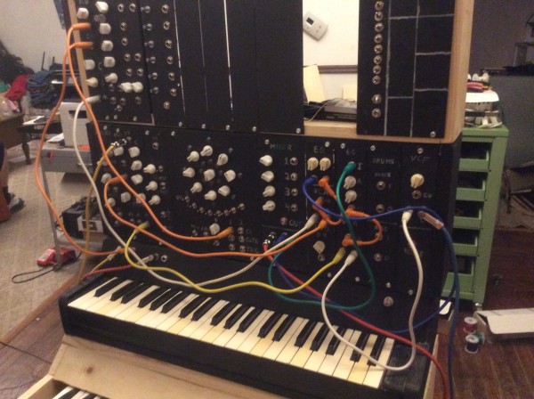

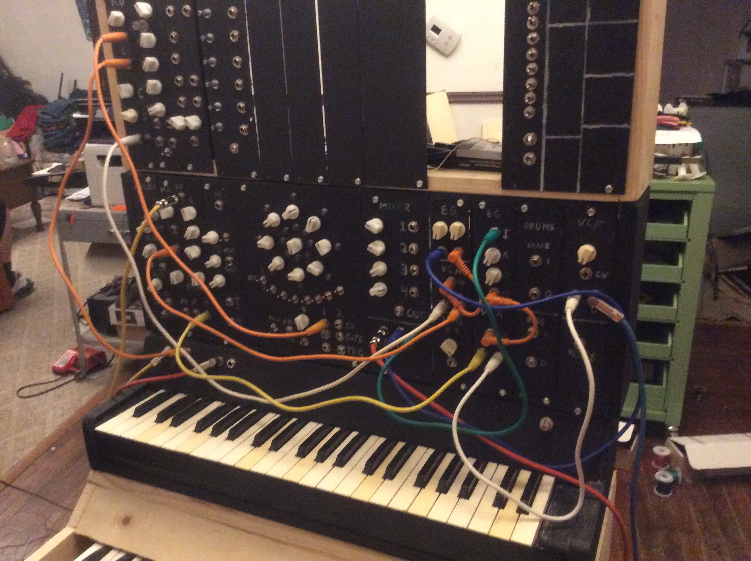

Thanks flareless.
I will check out your build link.
The key to building on perf is to design your modular with really big modules.
At 10 inches tall (25 cm) my modules can take really big perf board. This looks pretty easy to perf for my synth.
