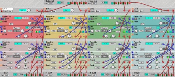

What ever happened to QUADRAPHONIC?
I cooked up this patch to mix each of the 4 mono inputs to a quad out (1FL, 2FR, 3BL, 4BR) speaker set up:
+ Input level control.
+ Fade front to back.
+ Pan left to right.
+ Switch manual or auto-pan.
+ LFO auto-pan modulation.
+ External and Bus inputs.
+ Controller knobs mappings.
Just a sketch. Lots of things to add to this like true 360 spins, effects, and more to be sure.
