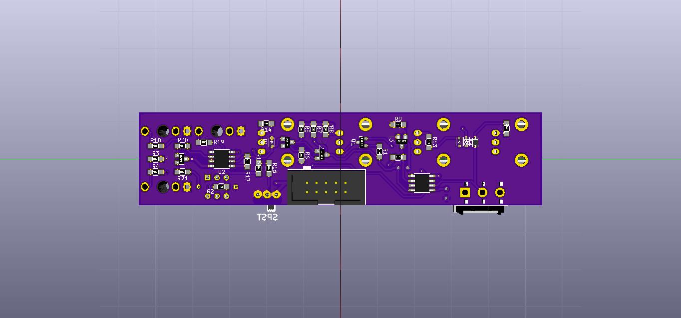

After a couple of hours of moving stuff around and reading datasheets I finally have managed to get almost everything to fit on a 25x109mm PCB, (with some margins to the edges)
When reading the datasheet for ICM7555 I noticed that pin 5 (Control) don't need a decoupling cap is it OK to leave it out, or at least put a ceramic 10nf instead of a "big" film-cap?
And another question:
I was first planning to have at least pads for the optional R17 and a small switch (easy to change range instead of having to solder on/off a resistor)
Thinking of it twice: Do I really need it? According to the "euro-standard" negative Envelopes goes from 0 to -8V
i have done it that way (switchable neg/pos inverted envelope) and find it quite handy. while you may not use it in every patch i'd still include pads on the pcb for the switch. to my knowledge there is no "euro-standard", so i'd feel free to do whatever makes sense.
PostPosted: Fri May 27, 2016 3:01 am    Post subject: Reply with quote  Mark this post and the followings unread
The only real standard is the mounting and voltage rails.
Well, that's why I wrote "standard" Wink There is some kind of standard for the signal levels.
As I said,I was planning for it and that is what I've done in my first revision.
Then I realized a couple of things.
1) If its on the pcb I have to demount the module to change it, and then remember which mode its in the next time
2) It takes up room on the pcb Wink
A solution for no1 would be to have a slide switch accessible from the front, but squeeze that in on a 6HP panel is a challenge in it self
progress so far...
Another option is header pins on the back, with a jumper -- I did this to select fast/slow, with my adsr layout.
rhdf
Joined: Jul 11, 2014
Posts: 39
PostPosted: Mon May 30, 2016 8:00 am    Post subject: Reply with quote  Mark this post and the followings unread
I've found small switches with .1 inch legspacing, so its possible to put in a header instead.
That is, if I not decide to only have 0 to -8V. I can see me scratching my head why something doesn't do as expected just because I forgotten witch ADSR has the 8-0V mode Smile
Next version might get a panel-switch for it (and a bright red LED Wink )
