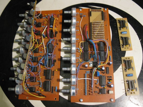

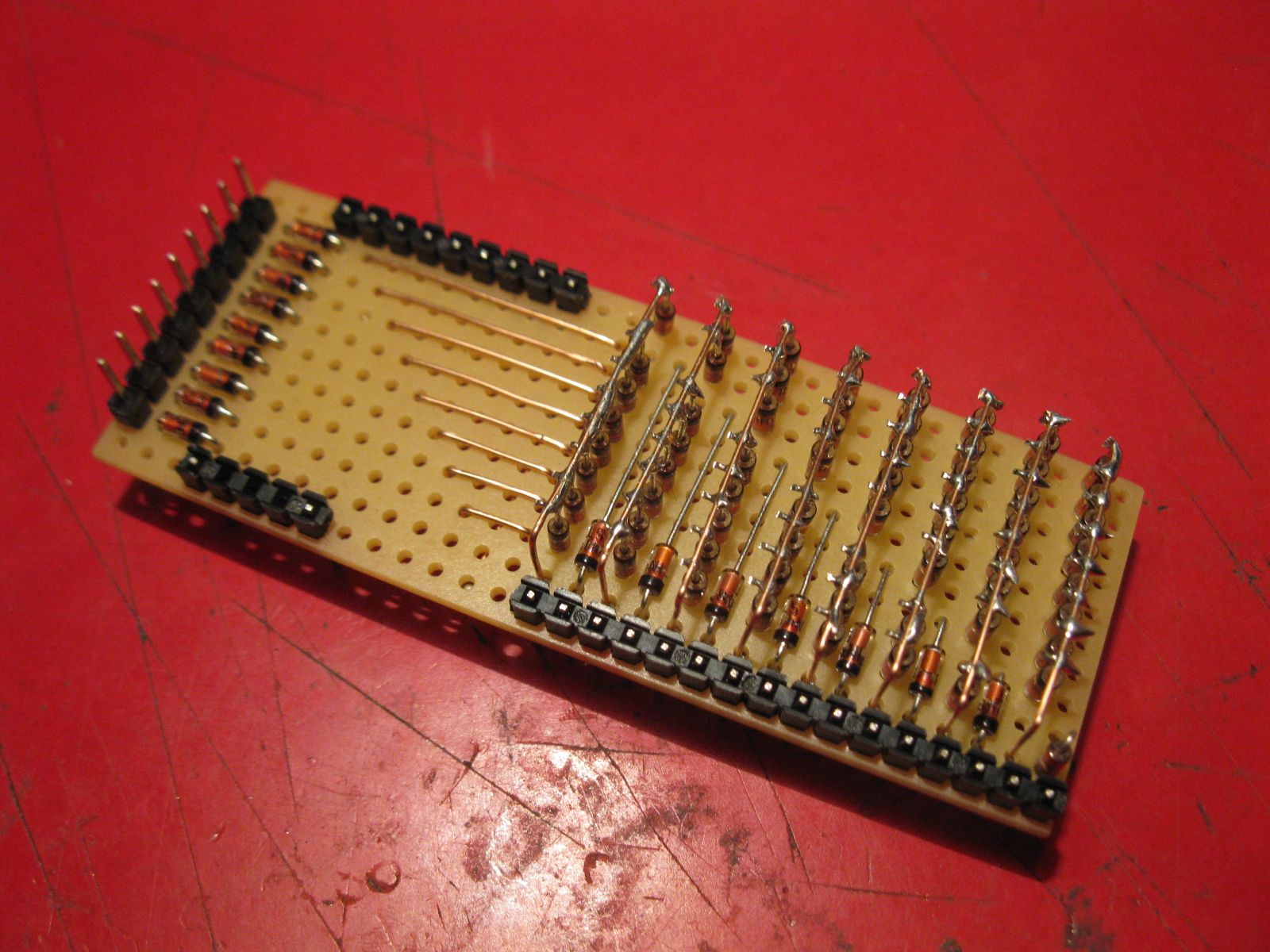

I've started building QuaZar a couple of weeks ago. Most of the circuit is soldered up but I was out of diodes so
couldn't continue. Shipping those took a bit longer then usual and I had almost given up on them but but they
finally arrived. To make the diode matrix I am first creating diode arrays.
step 1: bend the diodes at an angle on one side using one of those bending tools.
step 2: stuff the diodes into a piece of perf and wrap the legs around to hold them in place. Also add a piece
of copper wire to connect them together.
step 3: solder the diodes to the wire.
step 4: remove the diode array from the perf board by cutting of the legs that have been bend over the edge
and folding the other legs back.
step 5: cut the exces legs away.

This is what the finished diode matrix looks like which will be mounted onto a larger PCB.

gabbagabi
Joined: Nov 29, 2008
Posts: 652
Location: Berlin by n8
PostPosted: Wed Jan 10, 2018 6:52 am    Post subject: Reply with quote  Mark this post and the followings unread
wow,
how beautyfull!
Everytime i see your work i think may i should go back to perfboard Smile

Here's a photo of the rest of the circuit I've soldered so far. I am using the large PCBs I got from Cfish for christmas last year (thanks!).
I am currently waiting for push buttons which I ordered around the same time as the diodes and I really start to doubt they'll arrive.
Actually I also need some toggle switches and sockets so I am probably not going to finish it any time soon.

Posts: 5980
PostPosted: Sun Apr 08, 2018 9:02 am    Post subject: Reply with quote  Mark this post and the followings unread
It's not perfect but I finally finished the frontpanel Very Happy (after having to buy a new printer). Now I can check if the buttons fit.
I mean, they fit but the nuts are so close together that you can't really turn them. I do have some similar switches though
with round nuts, so those might fit better.
