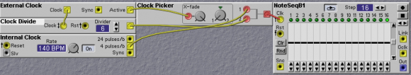

There are few sequenced patches in my synth, although they use internal clock generator.
When I connect to my sequencer, I'd like to use the midi clock instead so I figured I could easily put a fader to swap between the two clocks.
I see on Midi Clock module there is a "Active" port, and I wonder how I can make a generic clock depending on the fact that "Active" port has signal and if not use the internal clock gen of the patch.
I'm not yet familiar with the logic modules but seems someone more knowledgeable would probably be able to patch this and share this with us easily Smile
Thanks for the help!

How about this one?
I did not test it though.

Hey I think I tried that one but might not have tried the correct value on that x-fader knob, will give it a shot at night.

Got it working eventually, had to swap 1 - 2 and push X-fade knob all up and 1-2 knob all down.

Internal and external clock being chosen automatically depending on presence of external clock.
