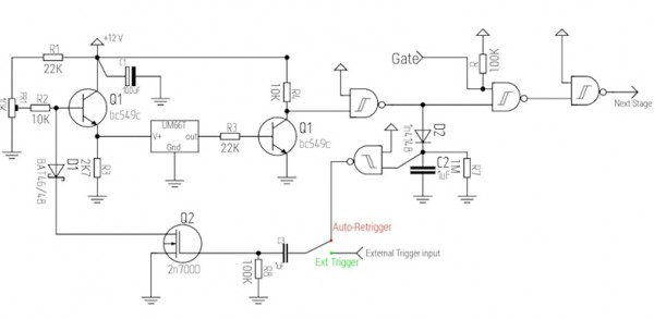

OK, well the basic tune is pretty cheesy "happy birthday," there are other varieties too. However I think it may have potential with subsequent processing. Im into CMOS just now so will likely be focussing on such technology for the required processing.
The chip is powered from 1.5 to 3 Volts so not immediately compatible with CMOS, but reasonably easy to interface.
When the chip is powered up it plays the tune once then stops. The output is just a square wave of fixed amplitude. There are no pauses between notes. When the cycle is complete the output goes low.
What I was looking for is the ability to trigger the circuit externally or for it to retrigger at the end of the cycle. In order to retrigger it is necessary to interrupt the power for a few hundred milliseconds. For some reason a shorter interruption doesn't retrigger the cycle, perhaps there's a capacitor on the chip?
I also wanted a gating input that is independent of the triggering process.
The circuit below satisfies these requirements and has been tested on a breadboard.
The output is CMOS 4000 compatible.
 Filesize:  67.65 KB
 Viewed:  444 Time(s)

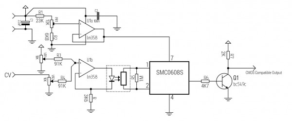

I've got another one the SMC0608S, it outputs a series of 6 different alarm/siren type sounds then repeats. It also has an external resistor that sets the internal clock frequency and can be varied over a wide range using this. It also has a stop/reset control pin.

The SMC0608 turns out to be quite interesting even with some fairly simple CMOS circuitry round it. Have tried A 4024 divider, digital ring modulation using an XOR & a square wave oscillator. I've also tried feeding it into my 4093 based filter with good effect, is more effective with binary division via the 4024 prior to going into the 4093 filter.

Here is the interface circuit for the SMC0608S, it should work with the UM3561 too:
Notes: I used a VTL5C1 Vactrol, with others you might need to change the 3K6 resistor, for example the NSL32 vactrols require much less current and something like 47K would work for them, however I found them to be much to slow for this application. It might be worth experimenting with making one yourself as the VTL5C1 can be a bit pricey.
The top opamp, in case you're wondering provides a regulated +3 Volt supply, as the chip draws less than 1mA plus the output current the lm358 can power it directly ( the lm358 can source at least 20mA )
Power supply was + 12 V
There are identical outputs from pins 5 & 6 on the SMC0608S, so the 4K7 resistor can be connected to either of these.
