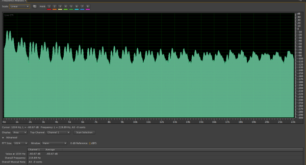

Here is a ChucK patch generated from data in a data sonification project that students and I have been working on for several years (note the raw_waveform and the hpf high pass filter). It spits out a WAV file generated from data being sonified.
EDIT: The code delimited block is screwing up the for loop headers, so I'll just attach the ChucK patch. The code below has at least two format errors.

Below are time-domain and frequency-domain snapshots from Adobe Audition.
If you literally want to generate the waveform, ChucK is probably easier to learn.
