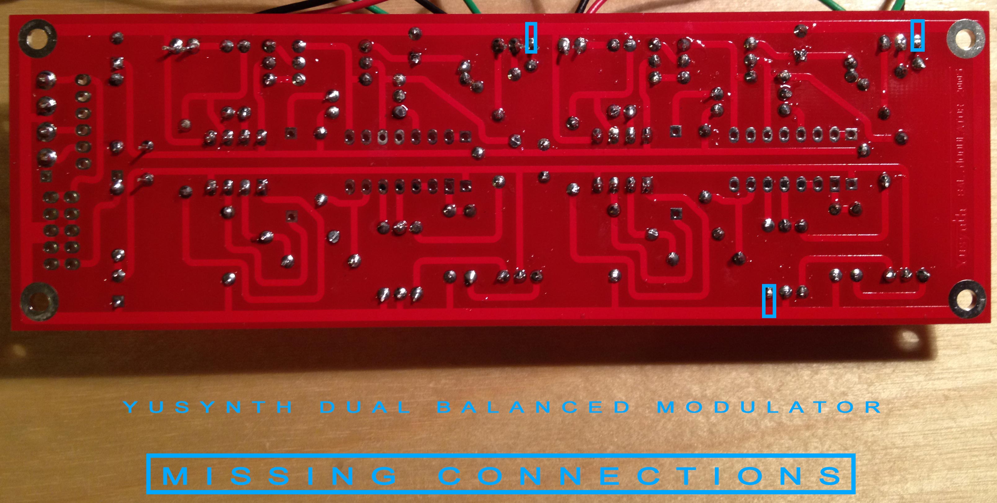

Hello all !
i am building some yusynth modules.
Boards are good quality & shipping was fast Wink
A have trouble with the ring mod >
Both sides are showing similar behaviour
althought measurements on 2nd amp of TL072 1 & 2 are not the same.
behaviour is : no (ring mod at) output, only very low level input 1 + 2
(bleedthrought i suppose - approx 20x less level than input )
I'm using a +/- 15V Power Supply
here are my voltages :
TL072 n1:
 Filesize:  1.97 MB
 Viewed:  397 Time(s)

It seems that the ground pad of the input connector misses a track to actually connect it to the ground, thus the 1.5K (R8 and R30) is not connected to the ground although it should be. Connect a wire between the ground pad pf this connector to the closest ground track.
There is also a missing track between R16 and the ground track.
Sorry about that I will have this corrected and will publish an erratum on Soundtronics
Yves

Corrections done.
Here is a picture of them >
 Filesize:  459.38 KB
 Viewed:  371 Time(s)
