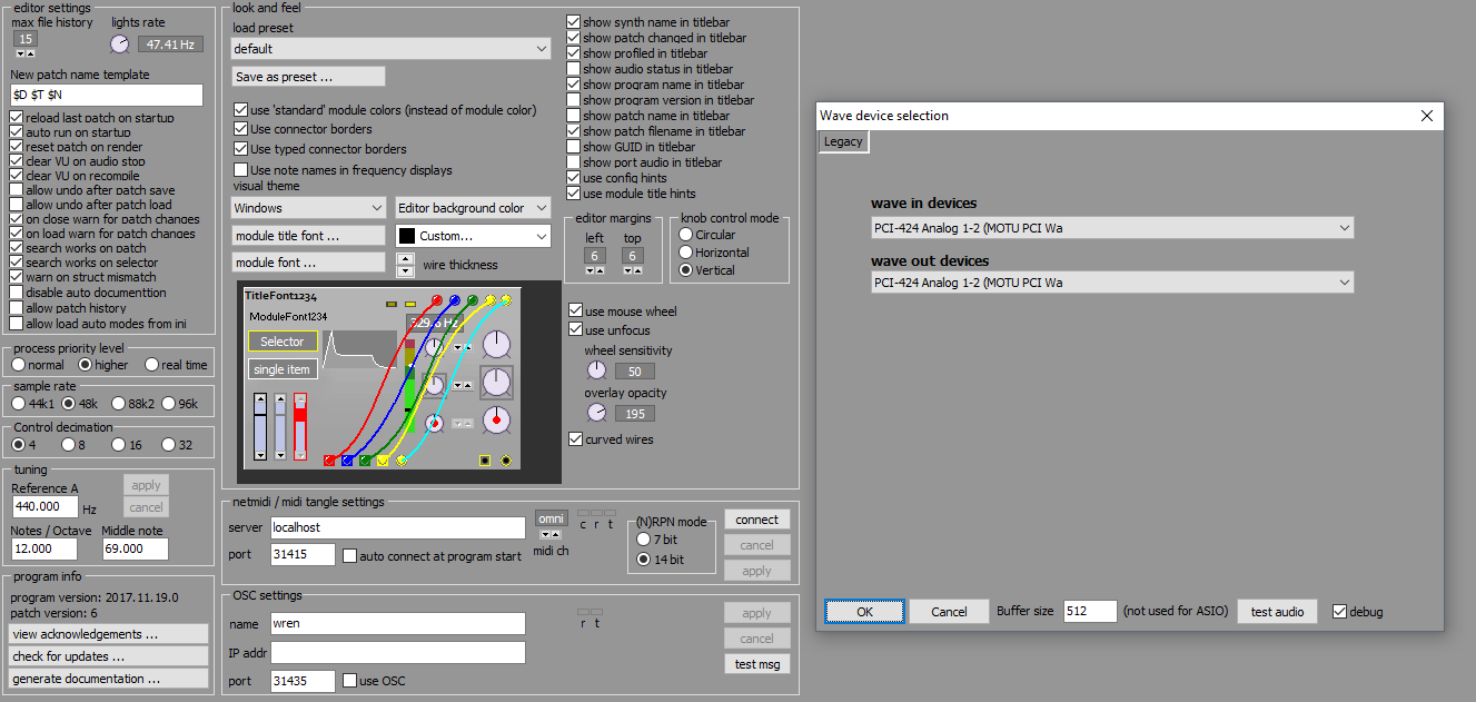

Hello,
First I'd like to say kudos on putting so much effort into this sweet modular freeware. I've been making tracks on the G2 Demo and this seems like it's miles better, excited to make the transition.
Although unfortunately I am unable to get it working. I read your stuttering explanation under FAQ and I just can't figure it out.
I am using Windows 10 64, and my hardware consists of a Motu PCI 424 card that is connected to a 1999 audio interface Motu 2408 mk2. Sample rate running at 48k, usually buffer is set to 512, and the driver I have selected in my DAWs is 'Motu PCI Asio'.
I also attached a photo of what options are available for me in Wren. What could I be overlooking?

hi blackout5,
I see that in the device selector you are only getting the legacy devices and not the port audio ones.
Assuming that you downloaded the wren zip file and have the port audio DLL in the same folder as the wren executable ... it then seems to be the case that the port audio DLL gives errors on startup.
Wren makes a logfile, there may be clues in it, maybe you can post it here? This would be "wren.log" and it is located in the wren folder.
What I've heard about is that on Win10 the port audio DLL is not working well with some of the on board audio devices. I've never had this issue myself though so not quite sure how to fix this ... well probably I'd have to supply a new DLL .. but maybe (just some stuff I would try myself, but never heard about anyone actually trying) it would be possible to:
a) disable the onboard sound devices in the device manager.
or b) Use a port audio DLL obtained from somewhere else
EDIT: things could still work with the legacy devices, but you would need a far greater buffer size than 512 then.
The device selector when using ASIO should look something like :

Actually the Port Audio tab did exist up until I uninstalled FL Studio ASIO, I did not uninstall FL Studio itself.
I also have a laptop with Windows 10 and a M-Audio 410 Firewire interface. When running Wren I was experiencing the same stuttering. I then uninstalled FL Studio and FL Studio ASIO altogether and the stuttering had disappeared. Although I wasn't able to repeat this reaction. I wanted to know if it was FL Studio or FL Studio ASIO that was causing the trouble and after installing both, the stuttering had returned, although stuttering persisted after uninstalling both applications again. I even tried to reboot without the audio interface but this didn't help and the Port Audio tab was still unavailable. I don't remember if Port Audio tab existed without the stutter.
I tried Wren on a 3rd Windows 10 PC that has never had any DAW's installed. Wren worked without issues and Windows DirectSound selected in Port Audio.
Returning to my initial PC with the Motu interface, I tried your binary advice. 'libportaudio32bit.dll' had stuttering and the log was identical with your DLL, and when I tried 'libportaudio64bit.dll' there was still stuttering but the Port Audio tab had returned and the log had errors.
Also another thing to note, in all cases if the Port Audio tab was present with stuttering, none of the drop boxes had any options and the Asio Panel button doesn't do anything. I attached a screenshot of how this looks like along with the logs.
Audacity works as expected.
Just a guess, I don't think it's Windows 10, or the DLL itself, perhaps there is some conflicts between software and drivers?

Ah! Hahaha... so up until now I have been installing Wren from the executable.
There is no issues with Wren from the ZIP. Everything is ok! Embarassed

Now when I attempt to change Windows DirectSound to MOTU PCI ASIO -or- ASIO4ALL, Wren refuses to run and goes straight to this log.
[Edit]
ASIO wouldn't run because I hadn't assigned the output/input channels. Embarassed
Wren from the ZIP also works on the laptop, no problem.

With the executable you mean the wren_setup_2017.11.19.exe file?
Then apparently I made a fuckup in that one ... it was tbh a bit of an afterthought to add an automatic setup. Maybe I should remove that for now and test better for the next release.
In you screenshots I saw you used a buffer size of 4096, setting it to zero and let PortAudio decide on the actual size has been working better for me.

Ok, and from the logs I can see that the 64 bit PortAudio DLL is not being properly probed (Wren is 32 bit software, so that was to be expected).
The 32 bit one and the original one (also 32 bit) seem ok, and then it seems like legacy audio was selected and started as PortAudio was not activated.
And in the last log indeed the number of channels was zero.

Hey! Some very significant data here.
So updating Windows on the laptop didn't break Wren. The Port Audio tab was showing up and Windows DirectSound was selected, all is beautiful.
UNTIL...
I installed FL Studio; As soon as FL is installed Wren breaks. I installed the latest demo from their website, you don't even need to run FL Studio for it to take affect. The installation includes, FL Studio itself, FL Studio ASIO, and ASIO4ALL. As mentioned before, in Wren, Port Audio tab is available but there are no options to select in any of the drop-boxes. As soon as FL Studio ASIO is uninstalled everything is back to normal.
[edit]
But for some reason it's not the same remedy for my Desktop PC with the Motu setup. Instead of fixing the Port Audio tab, returning all the options to the drop-boxes, uninstalling FL Studio ASIO completely removes Port Audio tab.
[edit]
I think I might be missing integrated audio drivers... Embarassed
[edit]
Nope... that didn't help either. Although this lead me into another interesting problem. I am not receiving any audio from my motherboards audio jacks, even with the correct device selected in Windows. A lot of ground noise though.
I have not been consistently checking the processes with the different installations, but at the moment Wren is the only one that has such a file when it runs.
Starting to think it might be a hardware issue. Or maybe my integrated audio has some registry issues caused by VBAudio or Virtual Cable (I don't have these installed anymore). I will report back.

Bluehell, I want to thank you for your help with clarity and suggestions, especially along with my lack of knowledge on the topic.
I had figured it out, I don't know why it works, but it works, hopefully once and for all.
All I had to do is delete the old Wren folder and unzip a new one, it worked. Perhaps it was having a difficult time re-initializing all audio drivers and running a fresh Wren helped?
And decided to test it once again:
1. Wren Working Properly (PortAudio present with all options available)
2. Installed FL Studio 12 (including FL Studio ASIO)
3. Wren PortAudio tab options in drop-boxes no longer available, Wren is stuttering.
4. Uninstalled FL Studio ASIO.
5. Wren PortAudio options have returned, Wren functions properly.
note, I have not ran FL Studio at any time during this test.

this is exactly my issue 3 years ago:
http://electro-music.com/forum/topic-68447.html
the problem is only related with FL Studio ASIO, not with FL Studio itself.
uninstalling that driver made I/O avaible again.
hope it gets fixed someday,FL Studio ASIO is very important to me since i can hear the audio from FL Studio and other applications (like YouTube) at the same time,until then i cannot use wren modular.

PostPosted: Tue Jun 23, 2020 3:37 pm    Post subject: Reply with quote  Mark this post and the followings unread
Great, thanks!
this makes it clear the issue is in initializing FL ASIO. And that also makes it clear that PortAudio could be changed to not give up searching on such a crash - but instead skip it .. as ASIO4ALL seems to be detected fine.
Could this be a 32 / 64 bit issue? As in FL ASIO being 64 bit only where Wren is 32 bit only .. currently.
