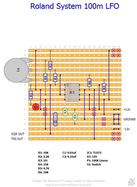

Hello
I found this stripboard layout, called " system 100m lfo" but no further information. I can not imagine that the system 100m lfo is so simple.

PostPosted: Mon Jun 11, 2018 11:44 pm    Post subject: Reply with quote  Mark this post and the followings unread
http://www.florian-anwander.de/roland_system100m/
Florian Anwander has the schematics for the 100m here.

PostPosted: Tue Jun 12, 2018 2:02 pm    Post subject: Reply with quote  Mark this post and the followings unread
Thanks for the tip, it just does not work yet

PostPosted: Thu Jun 14, 2018 3:40 am    Post subject: Reply with quote  Mark this post and the followings unread
i used a broken led, now it works.
